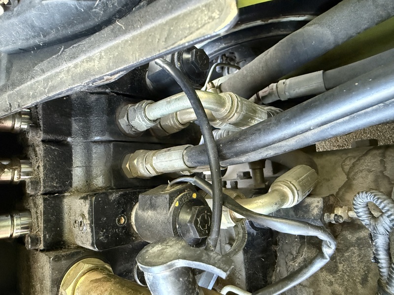

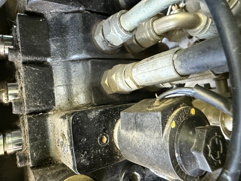

Yes , see the solenoids ? Make sure as key is on and sitting in seat that you have battery volts to them also check the plugs on them as well one is a lock out solenoid it cuts out hyds if not in seat

Is this the valve you were concerned with?

Can you post picture of control valve ?
Some have a solenoid that shuts off hyd
Unless on seat if it does it will be mounted on valve and has two wires a positive and negative check the plug for voltage while sitting in seat could be a bad connection and that's why it works when hit a bump also check for loose fuses etc
