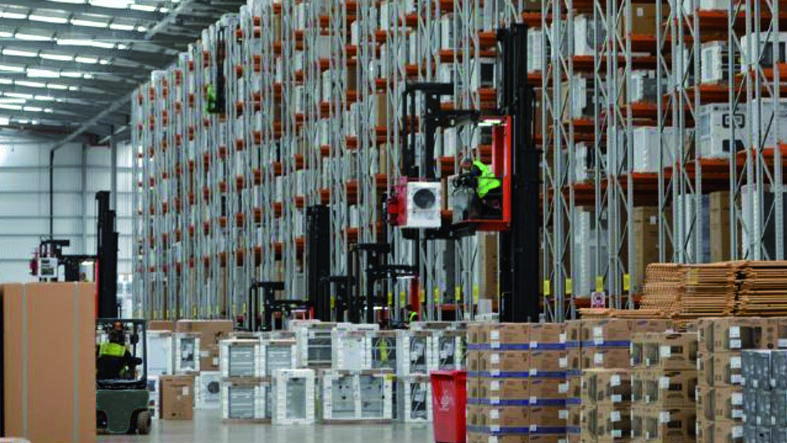

Bolzoni Auramo carton clamps fitted on VNA trucks and electric powered counterbalance trucks in a logistic platform, with very high level of product differentiation.

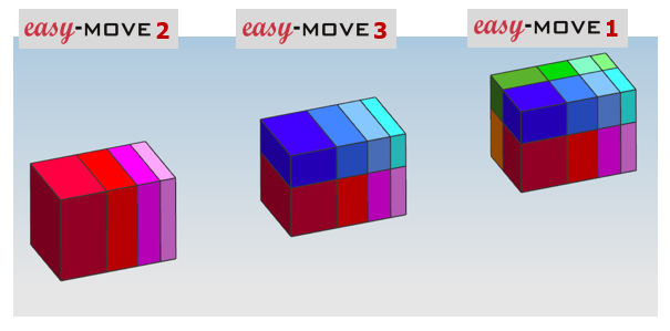

The three Easy-MOVE versions, which differentiate according to load configurations
Easy-MOVE 1 until 16 different load configurations
Easy MOVE 2 until 4 load configurations
Easy MOVE 3 until 8 load configurations and double sensors for presence detection

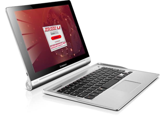

The micro-control can be connected via USB to Bolzoni configuration tablet and through an easy procedure (touchscreen based) the operator can adjust the handling and load parameters, recalibrate the sensors if necessary, associate the opening ranges to the required pressure levels and possibly recalibrate them in case of introduction of new loading scheme. "It is also possible to switch to single pressure manual mode," adds Lucchini. "Easy MOVE is the perfect attachment for 3PLs. In facts, this system does not require any additional competence and knowledge from truck driver."

"As standard," adds Lucchini, "all clamps are ex factory preset with load and pressure parameters agreed with the customer. In case the load parameters have to be updated, with a dedicated tablet, supplied by Bolzoni Auramo, the end user can adjust parameters, through a user friendly interface: adjust opening range, pressure values, to calibrate sensors and to set the clamp in manual mode."

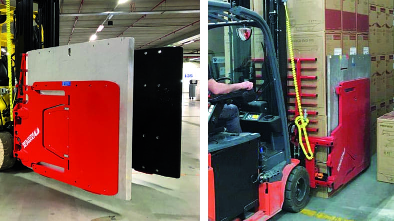

"The target is to generate tangible savings and assets for the end user," says Vittorio Lucchini. With new rigid arms KS-CF carton clamps the customer can count upon a steel panel with vulcanized rubber screwed on the carrier, that allows easy replacement after long period of use without changing the entire arm. This, maintaining a very limited thickness, only 26 mm, for easy knife-in operations between very tight spaces of products laying on the floor.
The same concept is also applied to the pallet handling version offering 180 mm high bottom rubber, or diamond plate tiles. "This massively reduces the cost of ownership in all cases where rubber can get quickly worn by the pallet friction."

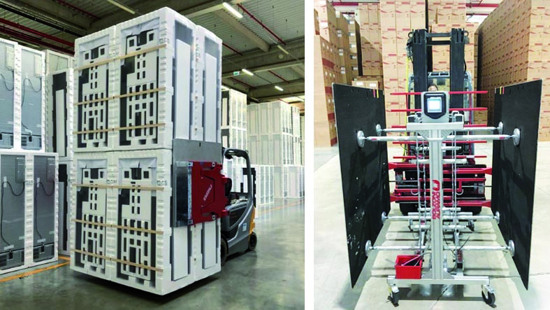

Thanks to the user friendly registration of four thread screws that impact on the arm camber, this patented Bolzoni Auramo system allows perfect distribution of the clamping force over the arm's surface.
This system has been tested and implemented for a long period in cooperation with one of the main distribution centers in Italy working 24/7. This pad configuration performed to be more resistant to mechanical deformations, in comparison to most of competitors' clamps after a long period of use.
"To make the clamp suitable to all possible load hardness and picking configuration, the clamp integrates a toe in adjustment," says Vittorio Lucchini. "And this in addition to the complete pads protection through hardox plates, vulcanized rubber, cut out of the alu panels' corners to ease limited tilting, total reversibility left-right / bottom - up which are common features to all types of Bolzoni Auramo Meyer oscillating carton clamps."

Bolzoni Auramo has a complete set of pressure control devices, such as the Four Point Clamping Force Tester. All carton clamps are tested as standard ex factory, and delivered with a defined set up of a single imposed pressure value.
