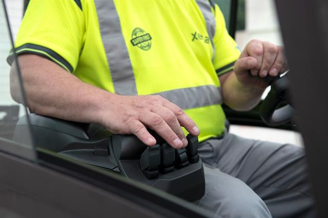

Ergonomic controls are essential to operating quickly, precisely and safely. For efficient manoeuvring, there’s a choice between a conventional ergonomic steering wheel and the Palm Steering option. The latter offers a relaxed driving position and requires minimal effort. The standard fingertip hydraulic control unit can be replaced with optional dual joysticks. If you prefer traditional manual hydraulic levers, those are an option too.
Several options are available for forward and backward direction control. With the standard fingertip hydraulic control unit or the optional joysticks, there’s a switch on the armrest. Optionally, in both cases, direction can also changed using a switch on the standard steering wheel column. This is also used when manual hydraulic levers are fitted.

Automatic tilt centring by pressing F2 button (on side) and activating tilt function (via fingertip lever) on fingertip hydraulic control unit.
