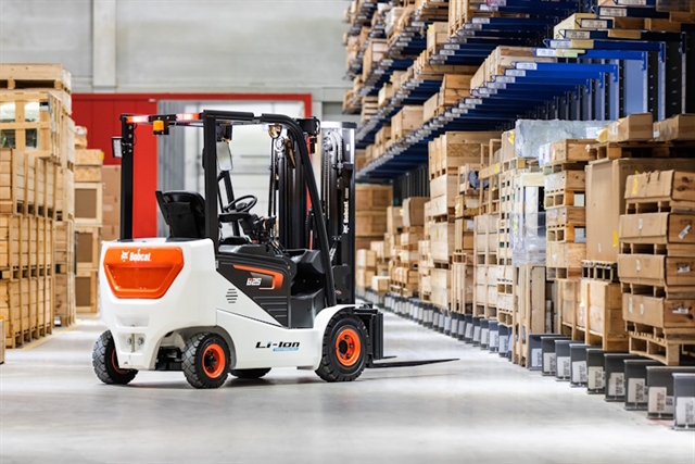

The further development of lithium-ion technology plays a central role. Like some other companies, Bobcat is also looking for modern alternatives to the classic lead-acid battery, in warehouse technology, for example. Lithium-ion batteries offer significant advantages: they are up to two-thirds smaller, maintenance-free, allow for fast charging and their service life is three times longer. Their more compact design opens up new possibilities in future vehicle design. Electric forklifts can, in principle, be designed to be significantly smaller and more manoeuvrable – an advantage in narrow aisles and confined spaces in warehouses. At the same time, ergonomics are improved: as the central space no longer has to be built around the battery, operator cabs can be designed to be more comfortable and functional.
Maintenance and charging processes are also more efficient. Lengthy charging times of six to eight hours are a thing of the past. The new lithium-ion batteries can be easily recharged during a lunch break or fully charged in around two hours during longer stoppage times. Additional advantages of electric drives are: no emissions, no odours, no dirt and, what’s more, less noise than diesel machines. This facilitates communication between employees and alleviates stress. In terms of CO2 footprint, electric forklifts are a particularly good choice for companies if they are charged via their own PV system or green electricity contracts. This allows the CO2 consumption of the forklift fleet to be reduced significantly and quickly. If you have your own PV system, you also stand to cut down on the cost of your energy supply.

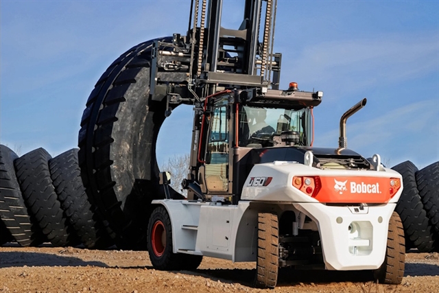

Diesel-powered models remain a popular option, particularly in challenging areas of application such as ports or heavy industry. Their performance is particularly appreciated for heavy-duty tasks and outdoor use. Diesel forklifts are characterised by their robust construction. Weather conditions such as rain, heat or frost have little effect on their operation, and the quick refuelling process further increases uptime. A diesel forklift can be made ready for a full shift within just a few minutes, minimising downtime. There are also economic advantages. The purchase costs are often lower than those of comparable electric models. On the other hand, electric models score highly for lower maintenance and operating costs.
