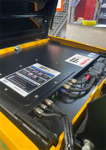

Industrial Batteries Australia’s Cooper says his firm has recently responded to the need for lithium-ion forklift batteries. However, there is still strong demand for their traditional CEIL lead-acid batteries.
“Battery maintenance and misuse are inherent issues with lead-acid battery life,” say Cooper. “Monitoring batteries for usage issues before a costly replacement can save businesses a lot of money and headaches.” To support business with battery care and maintenance, Industrial Batteries has recently introduced a five-year replacement battery warranty, which it believes is an industry first.
“A large customer had various fleet requirements in contracted service agreements around Australia,” says Cooper. “With their previous supplier, they lost a lot of money when battery warranties were voided for ‘battery misuse’. In some cases, it was battery failure, not misuse, but it was hard to prove. Our five-year replacement warranty has overcome these issues, saving them a lot of money.”

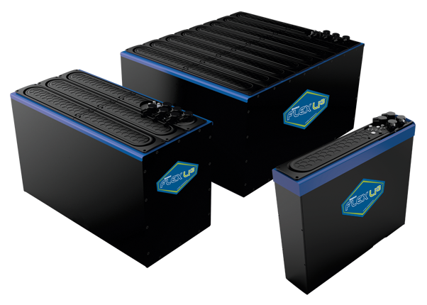

Hawker FLEX Li3
Hawker FLEX Li3
American-based Hawker claims to be the largest brand of industrial lead-acid batteries in the world, and it also offers lithium-ion batteries.  Dean Portney, Hawker VP sales and marketing, says the company carefully assesses the needs of its customers and then provides the right battery chemistry for each application, to deliver low costs and a convincing ROI.
While lithium may be the ‘big thing’, Hawker has enjoyed strong demand for its Hawker FLEX TPPL (Thin Plate Pure Lead) motive batteries.
Many customers are opting for a combination of TPPL and Hawker’s newer FLEX Li3 lithium solutions. Portney cites a large food manufacturing company where Hawker modelled different charge rates and battery capacities for each of their applications. “This company had previously tested competitive lithium batteries, but our data analysis convinced them to choose a hybrid solution. They have been extremely satisfied with the resulting efficiency and cost savings.”

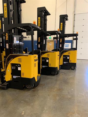

OneCharge’s Karimov says the company excels at developing new models of batteries to fit the requirements of operations with different work hours, in different industries, and with different loads.
“We have developed models for extreme cold conditions, where batteries are working and being charged at sub-zero temperatures, never leaving the cold storage facilities,” says Karimov.
He cites a large US beverage distributor which ran a temperature-controlled warehouse with two shifts daily and a fleet of 17 sit-down lift trucks powered by lead-acid 36 v forklift batteries.
“The company decided to switch from lead-acid to OneCharge Li-ion batteries. The purchase of six Yale ESC035AD stand-up lift trucks and six Yale ERP035VT sit-down forklifts powered by a 36 volt lithium battery allowed Standard Distributing to streamline its fleet from 17 trucks down to 12 to do the same job.”

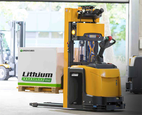

Green Cubes Technology's MultiVoltage SAFEFlex batteries

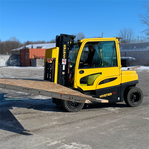

Green Cubes Technology is another US manufacturer of lithium batteries which specialises in designing batteries for harsh environments. Robin Schneider, director of marketing, says that the Green Cubes MultiVoltage battery technology allows charging at twice the output voltage for half the time, making opportunity charging even more effective. She  says they had introduced a new line of multi-output chargers capable of fast-charging three batteries at a time.
Schneider cites a major beverage distributor which replaced 23 lead-acid batteries with Li-ion batteries in 5,000 lb. (2,200 kg) sit-down Hyster trucks. “They were able to replace 850 Ah batteries with 600 Ah batteries for the same run-time. They also implemented high-frequency fast chargers. They saw improvements in warranty, maintenance, safety and utility cost and shorter charge times.”

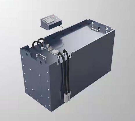

BSLBATT's modularisation allows forklift OEMs and end-users to 'build their own' lithium battery
BSLBATT is a lithium-ion battery manufacturer located in Guangdong, China. Hugo Chen, product director, says that modularisation is the key to meeting the power needs of different handling industries.
Modularisation allows forklift OEMs and end-users to 'build their own' lithium battery within 135 Ah increments and treat every individual module as an independently serviceable battery.
His company’s lithium modules are equipped with voltage acquisition and temperature sensors so that battery voltage and temperature changes are monitored in real time – a great aid to the performance and safety of the battery.
“BSLBATT has developed the very first 135 Ah lithium modules capable of forming parallel building blocks in a forklift battery compartment,” says Chen. “The modules can stack up to 20 in parallel for a total of 2,700 Ah. Each is independently connected to the internet and the cloud, thereby reporting continuous health updates. The modules can be remotely activated or deactivated if a fault is detected. Finally, the modules are constructed for quick and easy swapping: simply slide one out and put the new module in.”

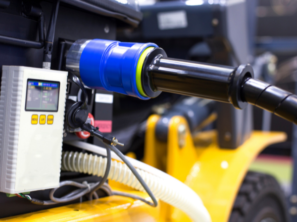

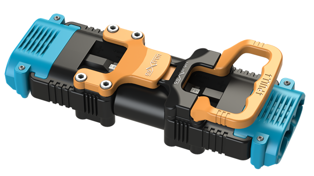

Eaxtron's new 430A Fast Charge connector
The move to faster charging has brought new challenges, according to Eaxtron’s Bourdy.
“As the batteries and equipment evolved, the weakest point became the connector. With fast charge applications, higher currents are needed, more charging operations occur and, with them, more risks of hazards due to improper connections, hard to pull connectors, or unsecured installations,” he explains.
To meet market demand for more robust connectors, Eaxtron has introduced a new option, the first-ever Fast Charge Effortless connector which has been UL approved for continuous charging at 430 A, without requiring larger cables than 4/0 (120 mm²), and within the same dimensions as the more common 320A connectors.
“Our patented locking device is the safest system on the market. Its design prevents electrical arcing by ensuring the connectors can’t disconnect by accident during the charging or the powering of the equipment,” he adds.
