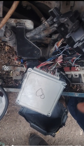

Im electrical technician Toyota forklift.
I have a error code 06-03 in Toyota 8FG30.
I check everything such as EThro fuse.
All wiring.throttel body and DC motor Ohms.
Accelerator.

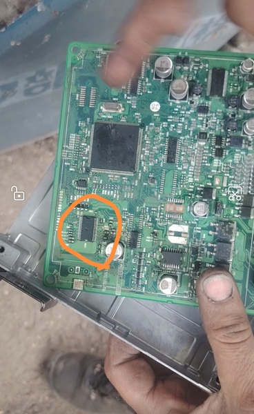

So I check ecu and found problem in throttle motor IC(transistor).
I replace all IC,diode, resistor.....
But error code wasn't clear and throttle body doesn't work.
Do it need reprogramming ecu or this ECU didn't repair for this error?!!
