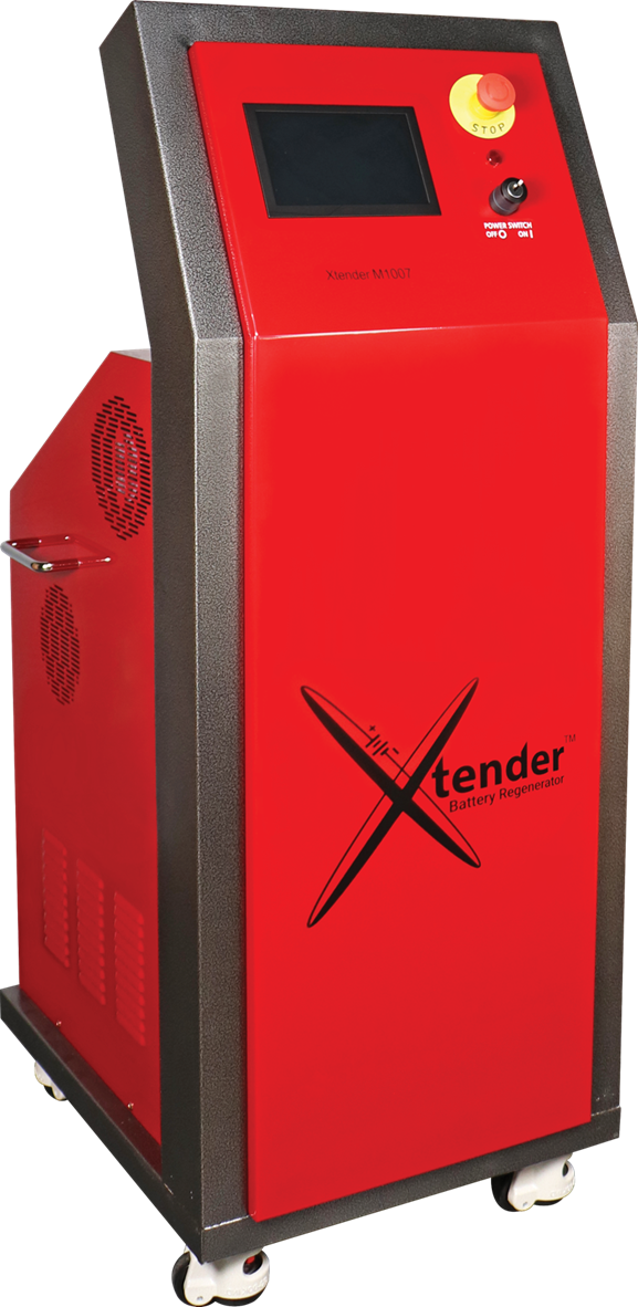

FSIP Electronics offers a range of products and services designed to maximise battery life and efficiency
According to Love, this typically includes weekly equalise charging – which is a process that limits corrosion and sulfation build-up and ensures all cells within the battery are balanced – as well as a more intensive desulfation cycle that is performed annually.
“A lead-acid desulfation cycle, or reconditioning cycle, typically entails multiple tests and multiple charging cycles. It can take anywhere from 3-15 days to fully recondition a lead-acid battery, depending on the equipment being used,” Love adds.

For lead-acid batteries, the Xtender Battery Regenerator provides automated, unmanned battery reconditioning through a stringent desulfation process tailored to specific user needs.

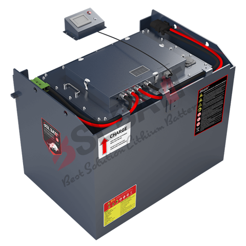

As Ling Peng, chief engineer at BSL New Energy Technology, sees it, while forklift batteries usually can receive a second life, the first step when deciding if this is even necessary should be to fully charge the battery using a balancer.
According to BSL New Energy Technology, balancing can greatly improve a battery's endurance
If there are no significant issues, refurbishment or remanufacturing may not be necessary, and balancing alone can greatly improve the battery's endurance.
“If the battery’s endurance remains short even after balancing, you can analyse the voltage differences between modules and cells during discharge using display data to assess whether refurbishment or remanufacturing is warranted,” says Peng.
According to Peng, there are two scenarios requiring refurbishment or remanufacturing. The first involves reassembling the modules within the battery pack, and the second involves reassembling the individual cells within a module.
The general criterion for cell evaluation is that cells with a remaining capacity of 80% or higher can be reassembled. After reassembly, it’s essential to check the Open Circuit Voltage (OCV) and the overall appearance.
“The first scenario is relatively simple and does not require complex equipment or procedures,” Peng adds. “If only a few modules within the battery pack are damaged, the modules can be reassembled into a new battery pack by performing capacity matching, internal group testing, data selection and assembly.”
The second scenario is more complex and involves dismantling the damaged modules to replace the defective cells before reassembling them.
“This process requires various equipment and procedural steps, including module disassembly, busbar disassembly, cell terminal cleaning, OCV testing, cell capacity testing, data selection, module assembly, and group testing,” Peng continues.
“There are certain safety risks involved, necessitating professional, personnel and protective measures.”

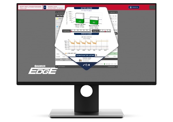

Hawker offers monitoring devices, software and reports which monitor a wide range of operational and maintenance items
As Dean Portney, vice president sales and marketing at Hawker says, when a battery is beyond its economic life, it’s time to recycle.
“Choosing a recycler for a particular chemistry is important to ensure the recycling is done safely by a certified recycler and one who recycles the greatest percentage of the product,” says Portney.
“Lead-acid batteries, both flooded and thin plate pure lead (TPPL) have the greatest percentage which can be recycled. Then, in the lithium field, it depends on the particular chemistry.
“Nickel manganese cobalt (NMC) batteries have recoverable metals along with steel, copper and plastics, but Lithium Iron Phosphate batteries do not have recoverable metals, other than steel and copper.”
A battery manufacturer committed to innovative technology and data driven solutions, Hawker is a leader in the field of battery life cycle management.
“We have designed and created monitoring devices, software and reports which monitor a very wide range of operational and maintenance items,” says Portney.
“These items are displayed in the form of warning alerts, life cycle predictions and other management tools to drive the longest life cycle. They can be downloaded on site with smart devices or remotely with our gateways and software.”

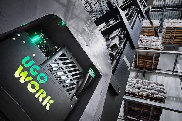

Ugowork has become involved in a new era of energy management that aims to reduce carbon footprint and costs
According to lithium-ion manufacturer, Ugowork, batteries that can no longer hold a charge or perform their intended function effectively are of no further use to their owners. At this stage, proper disposal is crucial to prevent environmental harm and to recover valuable materials.
Correct disposal through recycling is essential for all battery types to minimise environmental impacts. For lithium-ion batteries, this involves working with certified recycling partners who are able to safely process the battery, extracting and repurposing resources like lithium, nickel, and cobalt for use in new batteries.
While lead-acid batteries have a more predictable end-of-life, their lead content means that, if not disposed of correctly, they pose greater environmental risks.
“Today’s industry is shifting towards high-performance products to meet safety, productivity, and sustainability goals.”
Philippe Beauchamp, President and CEO, Ugowork

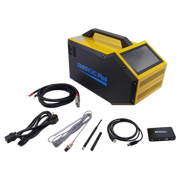

The Energic Plus regenerator converts sulfation into density and restores battery capacity
TVH, one of the world’s largest suppliers of forklift parts and accessories, is another company with a focus on innovation. According to Cedric Van Lancker, TVH category manager, Energic Plus, one of the company’s private labels and a specialist in the regeneration of batteries, epitomises this.
Energic Plus specialises in advanced flooded, gel, absorbed glass mat (AGM) and nickel-cadmium (Ni-Cd) battery regeneration technology.
“Our highly sustainable products are designed to extend the operating lifespan of industrial batteries, significantly reduce maintenance and energy costs, and enhance overall efficiency for our clients,” says Van Lancker.
The Energic Plus regenerator converts sulfation into density and restores battery capacity. This two-in-one device combines discharging and regeneration functionalities into one and offers many more advantages. It simplifies the desulfation process, requires less attention from users and is fully automatic.
“Some of our newest features, such as multi-voltage/current usage and its compatibility with BMS make it an even more innovative product,” says Van Lancker.
“For TVH we invest furthermore with our Energic Plus regeneration program to expand the life cycle of the battery fleet to optimise the investment before the batteries must be replaced and will go towards recycling, the final stage of their lifetime.”
