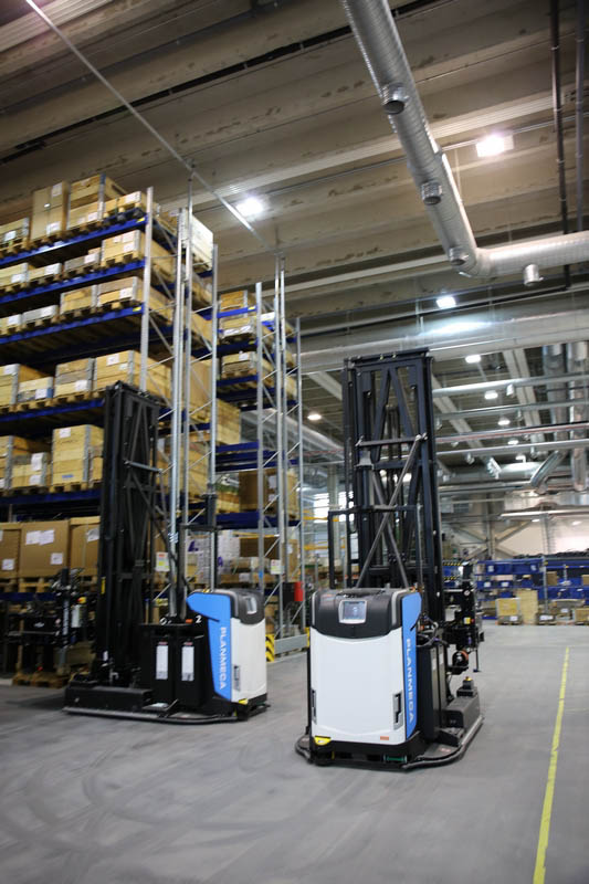

The AGV system used by Planmeca consists of two Rocla AWT-VNA AGVs supported by the Rocla MetRo warehouse management system (WMS). Rocla has tailored the AGVs to meet Planmeca's needs, for example by applying advanced mast technology. The vehicles are equipped with design covers supporting Planmeca's brand identity.
The Planmeca warehouse in which the AGVs operate shares the same space with the tooling and painting units. The environment is quite challenging. The aisles between the shelves are narrow and shelves are quite tall - the maximum lift height is 10 meters. The warehouse has 1800 pallet places and Planmeca uses a number of different pallet types and sizes.
On a busy day the AGVs are moving between the conveyor, shelves and the tooling and painting units almost all the time. Click for larger image
"They usually move the pallets about 50-70 times a day. The MetRo WMS automatically allocates the jobs for the AGVs, but of course the system also allows the priority of the jobs to be manually altered if needed", says Silander.
For navigation inside the warehouse the AGVs use laser triangulation, with the aid of reflectors installed on the shelves and walls.
