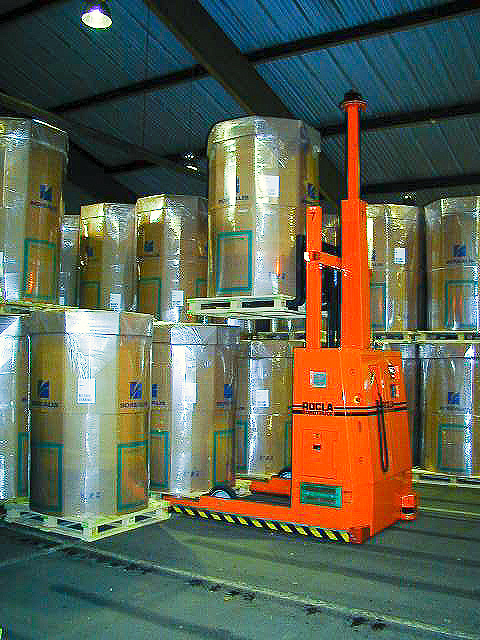

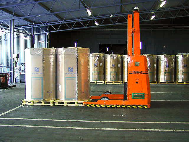

In 2001 Rocla received an order from Borealis which consisted of 10 AGVs. In 2003 Borealis added 4 new AGVs to the existing system. The 14 Rocla AGVs are transporting octabins from production to the storage and from the storage to dispatch area for lorries. An octabin is a special container - it is an eight edged cardboard cylinder placed on a pallet, approximately 1100x1100x1800 mm with a weight of 800 kg. The octabin is filled with polyethylene granulate. The storage is a buffer store for different production batches. There are two different parts in the storage: the largest part contains normal catalytic processed polyethylene and the smaller part for PEX, the super clean polyethylene. PEX needs to be stored in normal temperature so this part of the storage is heated wintertime.
The total warehouse area on site covers 24 700 square meters and contains 15 231 octabin pallets. The turnover factor is eight times a year. The flow has stayed constant during the eleven years of automation. In the storage lanes these octabins are standing two by two, on top of each other to get a factor two of storage capacity.
The automated transport system provided by Rocla could run 24/7 continuously, but at the moment it works 18 hours a day, 7 days a week, in both dispatch and filling the warehouse. The storage is automatically rearranged: When a stored batch in four lanes has been partly consumed, if there is a possibility to compress it in to two lanes a rearranging routine will start.
Special for Borealis is the load-on-load with height searching application: The polyethylenes granulate will compress during the time, especially since the second pallet on top presses the one below with its weight. For this reason the AGVs are searching the pallet tunnels with their sensors in the fork tips.

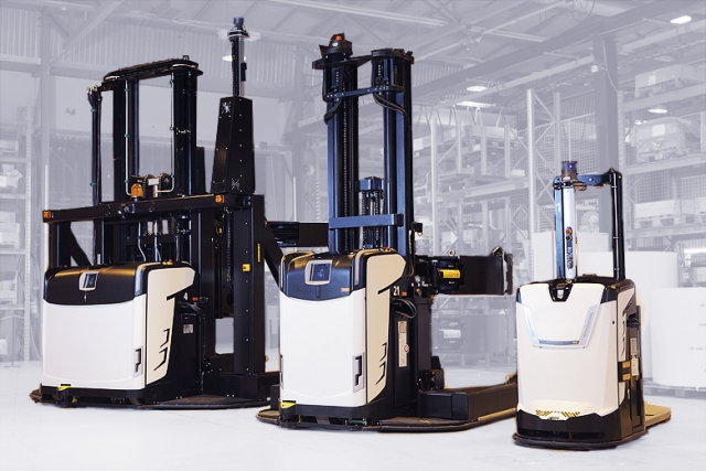

Today Rocla offers full line of modular AGVs for different customer applications.
