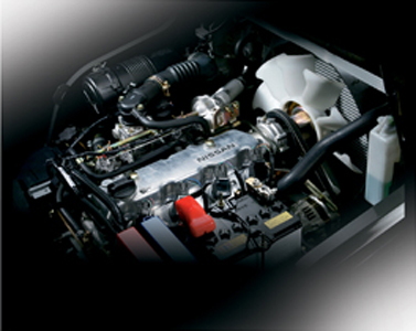

Nissan K21 & K25 Engines
The Nissan K21 and K25 engines are gasoline/LPG/dual-fuel engines that incorporate an improved cylinder design and combustion chamber shape, along with electronic control to effectively answer industrial requirements for reduced exhaust emissions, as well as high torque and power at low RPMs.

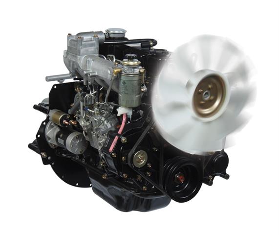

Nissan QD32 Diesel Engine
The QD32 Diesel engine exceeds all Tier III (2008 EPA) requirements for emissions. Its electronic Quick Glow System results in dependable cold weather starting.
