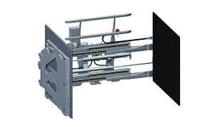

Cascade Sliding Arm Paper Roll Clamp Perfect for Container Loading and Unloading. Click to view larger image.

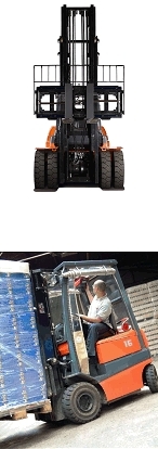

Reliable L-Series Fork Positioners are Virtually Maintenance-Free
Cascade L-Series Fork Positioners, designed specifically for heavy duty applications, such as the automotive, steel, and lumber industries are engineered and built to handle a variety of pallet configurations. Available in Class 2, 3 or 4 models, this Fork Positioner provides excellent visibility and versatility. T-bar style fork carriers and replaceable bearing segments ensure smooth fork movement. Drivers can accurately position forks without ever leaving their seat. With an opening range up to 2500 mm and equal arm travel, the L-Series Fork Positioner is made to handle the heaviest products in the harshest conditions.
Mobile Weighing Makes Sense
The ability to weigh product while moving it from one location to another, rather than taking it to a scale to be weighed, has a significant impact on throughput. Whether handling incoming receipts, preventing picking order errors, mixing, dosing or piece counting, mobile weighing saves both time and money. Cascade Sideshifters and Fork Positioners equipped with mobile weighing devices, using Bluetooth® technology enables forklift truck operators to weigh, view and track individual loads. Cascade, in conjunction with Ravas, will feature mobile weighing equipment.
Cascade Sliding Arm Paper Roll Clamps (2500-6500 kg) are extremely durable and perfect for stevedoring applications where tight stacking and the ability to handle either 1, 2 or 4 rolls is required. Unlike standard pivot arm Paper Roll Clamps, the arm profile of the Cascade Sliding Arm model does not change in relation to its opening width. This factor makes the Cascade Sliding Arm Paper Roll Clamp the preferred model in many stevedoring applications. Featuring thin arms for knifing between tightly stacked rolls of paper, the full width UHMW bearings provide maximum strength and bearing support, greatly reducing wear on bearing surfaces. The hydraulic circuit is readily accessible for servicing and provides over clamping protection as well as sideshift and backhand pressure relief. Models are available in both fixed arm and articulated split pad left arm (for multiple load handling). Both Cascade's patented HFC (Hydraulic Force Control) and AFC (Adaptive Force Control) are easily adaptable to these clamps. The arm speed and great visibility make these units a huge asset for logistics operations.
