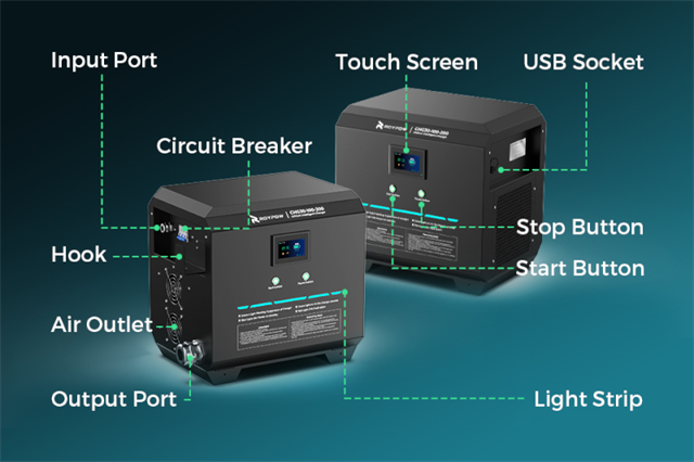

Features of ROYPOW Forklift Battery Chargers
ROYPOW has specially designed the chargers for forklift battery solutions. These forklift battery chargers feature multiple safety mechanisms, including over/under voltage, short circuit, Anti-reverse connection, phase loss, and current leakage protection. Moreover, ROYPOW chargers can communicate in real time with the Battery Management System (BMS) to ensure battery safety and improve charging efficiency. During the charging process, power to the forklift is disconnected to prevent drive-off.

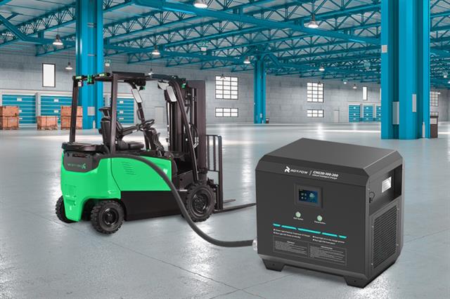

How to Use ROYPOW Forklift Battery Chargers
When the battery level drops below 10%, it will alert to prompt charging, and it’s time to drive to the charging area, switch off, and open the charging cabin and protective cover. Before charging, check the charger cables, charging sockets, charger casing, and other equipment to make sure they are in proper working condition. Look for signs of water and dust ingress, burning, damage, or cracks, and if not, you can go for charging.
First, detach the charging gun. Connect the charger to the power supply and the battery to the charger. Next, press the start button. Once the system is free of faults, the charger will start charging, accompanied by the illumination of the display and indicator light. The display screen will provide real-time charging information such as current charging voltage, charging current, and charging capacity, while the indicator light strip will display the charging status. A green light signals that the charging process is underway, while a flashing green light indicates a pause in the forklift battery charger. A blue light signifies standby mode, and a red light indicates a fault alarm.
Unlike lead-acid forklift batteries, charging the ROYPOW lithium-ion battery from 0 to 100% only takes a few hours. Once fully charged, pull out the charging gun, secure the charging protection cover, close the hatch door, and disconnect the charger power supply. Since the ROYPOW battery can be opportunity charged without compromising its cycle life — allowing for short charging sessions during any break in the shift schedule — you can charge it for a while, press the stop/pause button, and unplug the charging gun to operate for another shift.
In case of an emergency during charging, it needs to press the stop/pause button immediately. Doing otherwise could cause dangerous situations where electricity arcs between the battery and the charger cables.
