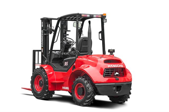

Forklifts in Hangcha's Rough Terrain series feature a wide body that can carry irregular and oversized cargo
“When traditional forklifts operate in harsh outdoor conditions, they often encounter issues such as difficulty climbing slopes, tyre slippage, getting stuck in mud pits and being unable to overcome higher obstacles,” says Shi Bingwei, senior engineer at Hangcha.
“In these settings, it is necessary to choose a forklift model with higher engine power and a chassis with a higher clearance. Sometimes, additional measures such as adding anti-slip measures are needed to enhance the forklift's ability to get out of difficult situations.”
Asked about Hangcha’s offerings in this space, Bingwei points to the company’s rough terrain forklift series, which he says are ideal for uneven and solid surfaces such as mountains, plateaus, snowy areas, construction sites, mines, orchards, pastures and rugged terrains.
“The vehicles in this series have a wide body that can carry irregular and oversized cargo. They boast a high ground clearance, enabling them to traverse obstacles on the terrain,” says Bingwei.
“Equipped with four-wheel drive and rough terrain tyres, they exhibit excellent off-road performance and can operate in harsh conditions like mud and rugged terrain.”

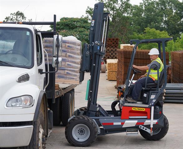

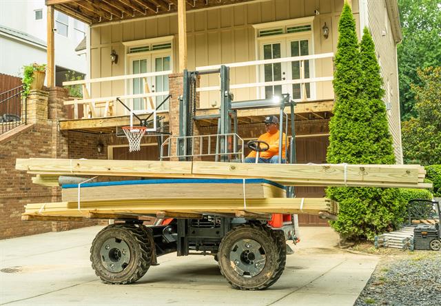

As well as negotiating difficult terrain, according to Palfinger North America’s product manager for truck-mounted forklifts, Jason Gaydos, simply transporting the materials to the site where they will be used can also be difficult.
Accessibility is an important consideration when transporting materials for outdoor use
“Often the delivery truck with the forklift can’t access or go off pavement to get as close as possible to where the load is required by their customer,” says Gaydos.
“Furthermore, drivers do not want to risk getting a loaded flatbed tractor trailer or straight truck stuck on the job site, which would mean down time and a costly tow service.”
In these cases, employing a product like the 2,268 kg capacity Palfinger FHS 55 Series truck-mounted forklift represents an effective solution.
A forklift capable of between 15% and 30% gradeability (depending on model and feature), it enables the spot delivery of the equipment as close as possible to the desired location, whether that happens to be up a narrow mountain driveway or down a busy city side street.
“Often drivers do not have the luxury of open areas to unload the truck or trailer from both sides,” says Gaydos. “That is why we developed a patented double reach system that allows the operator to park and unload the entire cargo form one side. This is better known in our industry as single-sided unloading.”
Pointing out that ergonomics and safety of both operators and bystanders were priorities when developing the forklift, Gaydos adds that the company also wanted a product that could handle dirt, rain, winter road salt, summer heat, extreme cold, gravel, sugar sand and the various other physical challenges associated with working outdoors.

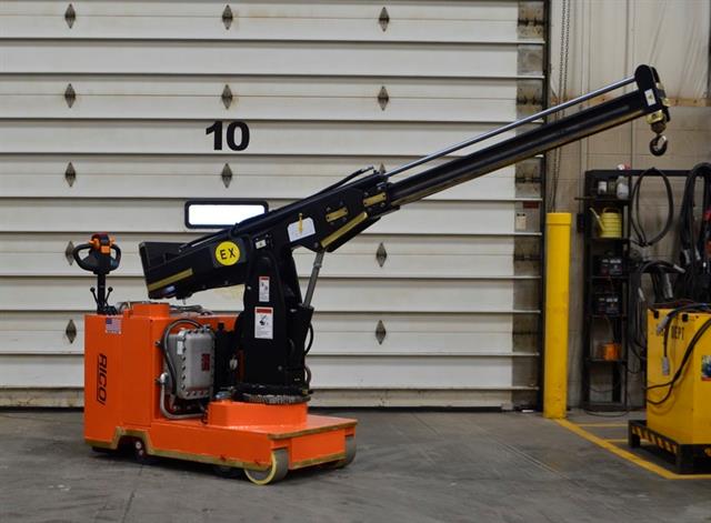

In some environments, such as those found in chemical processing, pharmaceutical production, paint and coating manufacturing, the petrochemical sector and even food and beverage manufacturing, the potential hazards involved in materials handling can be very serious indeed.
Rico Manufacturing offers various products suitable for environments in which the presence of flammable gases, vapours or dust makes explosions possible
“The primary challenge of operating in environments such as these is the risk of ignition due to the presence of flammable gases, vapours or dust,” says Jesse Kloos, director of engineering at Rico Manufacturing.
A North American leader in the production of explosion proof (EX) forklifts, Rico offers a range of products suitable for use in such environments.
According to Kloos, the company maintains explosion proof certification from Nationally Recognised Testing Laboratories (NRTL) for high lift straddle trucks, reach stackers, pallet trucks, platform trucks, sit down, standup and walk behind counterbalance trucks, tow tractors and crane trucks.
“Rico EX trucks can be used within any environment that has been classified as class I, division 1, group D and class II, division 1 and group G hazardous locations,” says Kloos.
Rico offers extensive EX industrial truck operational and maintenance training to ensure end users can safely maintain their Rico products.
“We also offer a compliance inspection program to ensure aging units still comply with all regulations and can operate safely in an EX environment. An explosion-proof truck is a big investment and we want to help our customers extend their return on investment on these units,” says Kloos.

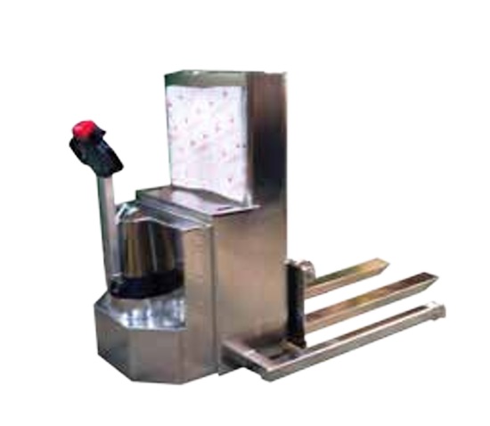

Unlike the challenges of operating outdoors, materials handling in food manufacturing settings involve considerations such as meeting hygiene standards and the capacity to operate in cold storage facilities.
Superlift Material Handling's Straddle Truck is suitable for both food and pharmaceutical production
“Food production requires the daily cleaning of most or all of the equipment in production facilities. Equipment has to be treated with harsh chemicals then washed down,” says Superlift Material Handling president Gerry Erwin.
Superlift’s product range includes a complete line of stainless steel products, which are suitable for both food and pharmaceutical production.
“Our lift equipment is built with these daily cleansings in mind. We have to ensure the equipment is designed in such a way that when water is on the equipment it does not pool,” says Erwin. “Cracks and crevices are to be avoided and the chemical needs to reach all areas of the equipment so that bacteria will be eliminated.”
At the same time, drainage and the capacity for air drying are also important design criteria.
Erwin says 316 stainless steel, which is anti-magnetic and less prone to rust than 304 stainless steel, is the material of choice for the range.

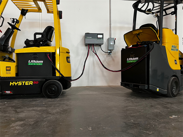

Cold temperatures like this also have implications for battery operated forklifts.
Green Cubes' lithium SAFEFLex batteries solve the problem of operating in cold environments
“Lead acid batteries suffer from severe performance degradation when used at cold temperatures, due to freezing electrolyte,” notes Robin Schneider, director of marketing at Green Cubes Technology.
“This is primarily a problem during charging. Traditionally, the forklift would be driven out of the freezer, where the battery can be charged safely at ambient temperature.
“The temperature needs to equilibrate with a total charging time of more than eight hours; for multiple shifts, batteries must be swapped and stored in a dedicated battery room. In addition to the inconvenience, there is danger of workplace injuries due to condensation.”
Designed as direct replacements for traditional lead acid batteries, Green Cubes’ lithium SAFEFLex batteries effectively solve this problem. Equipped with heaters that maintain the battery at a safe temperature when charging, they ensure that forklifts can be opportunity charged within the freezer in about an hour without battery swaps or watering.
“This simplified process eliminates the need for a battery room and mitigates the danger from condensation,” says Schneider.

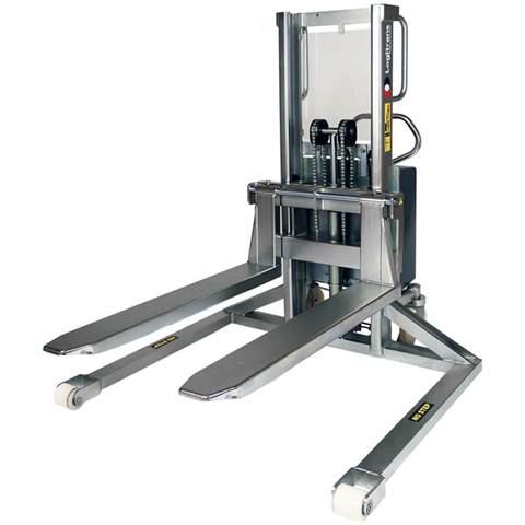

Another leading supplier, Logitrans (formerly Interthor), offers a range of stainless steel stackers, highlifts, pallet jacks and drum turners suitable for use in pharma clean rooms and food grade cold environments.
“We work together with partners in the various industries and from their feedback we construct products which will live up to the demands that they have,” says Jesper Jorgensen, vice president of sales at Interthor (now Logitrans).
Interthor offers a range of stainless steel stackers, highlifts, pallet jacks and drum turners for food grade cold environments

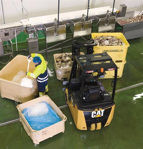

Illustrating the effectiveness of this approach, Jorgensen pointed to the example of French retail group Carrefour. As used in one of that organisation’s production facilities, Logitrans’s Rotator solved the problem of a bottleneck associated with handling large trays filled with crushed ice for cooling fresh fish.
A daily delivery of four big trays each containing 300kg of crushed ice had created a slow, time-consuming and physically stressful task for employees, who had to manually scoop the ice from the trays to the show racks to keep the fresh fish cold. This was a static movement, which caused back injuries and strains on the employees.
Now installed, the Rotator lifts and rotates the big trays 90 degrees and then allows the employees to quickly empty the trays without awkward or stressful movements. As a result, workflow was optimised, and a safer working environment was created.
