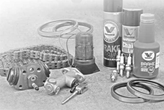

It's good to keep often-used parts handy
