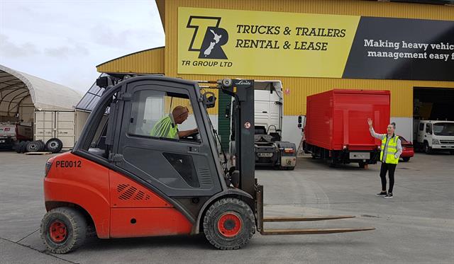

The pedestrian and operator should attract each other's attention
So, how does a pedestrian enter an exclusion zone and what should the operator do?
The pedestrian and operator should attract each other's attention verbally and/or by using eye contact and hand signals. Be aware of the potential for ambiguity; is that raised hand meant for someone over your shoulder?
The forklift operator should then bring the forklift to a stop, straightening the wheels. This is so that, in a moment of inattention during or after the communication, the operator doesn't drive forward with the result being the counterbalance swinging into the pedestrian standing next to the forklift. The operator should drop the forks to the floor, put the handbrake on and put it in neutral. Then the pedestrian can approach the forklift.
Once the operator and pedestrian have finished their communication, the pedestrian must exit the exclusion zone, then the operator is safe to move away. It's not recommended that a pedestrian talk to a forklift operator while they both continue moving, although there may be scenarios where this is required. The reason for this is that when we're talking to people we often look at them. If we're walking or driving at the same time, that means we're not looking where we're going.
