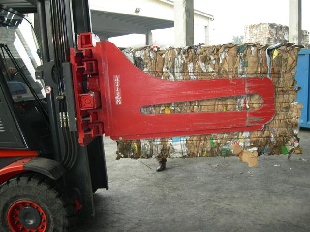

A.T.I.B. 116 serie Recycling Bale Clamp, loading operation

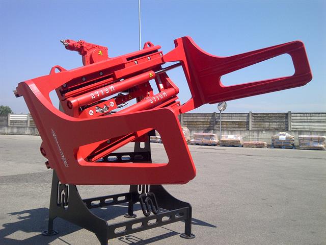

A.T.I.B. 360° Rotating Bale Clamp type 301.474.131

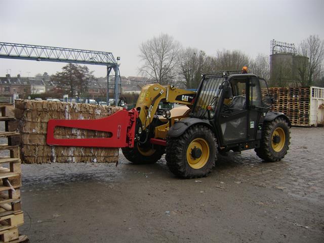

A.T.I.B. 474 serie Recycling Bale Clamp, loading operation
A.T.I.B. recommends to adopt the 474 and 116 recycling bale clamp model, which are specifically designed for heavy-duty handling of waste paper, plastic, metal and other recycling material bales. With capacities ranging from 1200 to 8000 Kg, these clamps are the ideal choice for all waste handling operations. All clamps in the range provide a high level of clamping force assuring safe bale handling.
The profile frame are available in aluminium and in strong steel and its structure is very rigid and improve stability when clamping. New bearings the full width of the chassis makes for reduced pressure to operate the clamp, thus ensuring smooth opening and closing and increases clamping efficiency. Cylinders and hydraulics can be well protected by a front plate shield, keeping good visibility all around the clamp frame. Arms are directly welded with full penetration to the sliding arms supports. The new arm design with improved clamping angels and teardrop profile improves clamping efficiency and reduces potential damage. The bale clamps are now able to gently follow possible sliding friction on the floor. As optional supply, replaceable wear bars are welded under the frame and the arms, providing additional wear protection.
For this specific handling case, A.T.I.B. offer a new clamp, with a new regeneration hydraulic valve utilizers the exhausted/return oil from one side of the cylinder to assist the operation of opening and clamping, assuring the synchronised movement of the two arms; this improves speed of operation and reduces the requirement for revving the truck saving on wear and tear on the hydraulic system and more importantly fuel.
