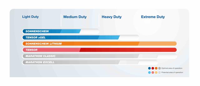

GNB has a world-class reputation in the forklift market, and an excellent track record of helping its customers reduce costs and optimize total cost of ownership. It has products that are specially designed for certain usage scenarios. The best choice for some businesses might be Sonnenschein Lithium, for example, while for others it might be GNB's high-performance lead-acid batteries like TENSOR or TENSOR xGEL. GNB takes the time to understand each customer's business, see how their operations work, and propose the most cost-effective solution for their needs.
Performance Categories

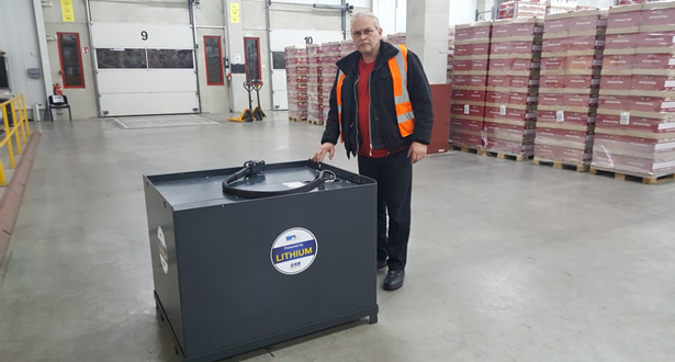

The endurance tests were conducted using the GNB Sonnenschein Lithium battery. It has a long lifespan of up to 4,000 cycles, an integrated battery management system, and is optimized for intermittent charging. It is low maintenance, has very short charging times, and energy density is increased by 30%. The battery is designed to reduce operating costs over its entire service life, leading to impressively low total cost of ownership.
Nominal voltage: 76.8 V
Nominal capacity: 552 Ah
Battery dimensions: 852 × 1,025 × 784 mm
Battery weight: 769 kg
Tare weight of trough: 176 kg
Ballast weight: 935 kg*
* To reach the specified total weight of 1,880 kg
The GNB 2100 HP Lithium 78 V 200 A charger was selected. It has a full charge cycle of 2 hours. It supports seamless 2- or 3-shift operation via intermittent charging, and is optimized to get maximum performance out of a GNB Sonnenschein Lithium battery.

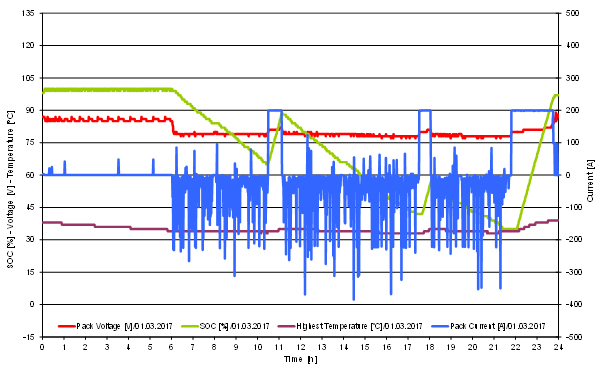

Sonnenschein Lithium successfully handled a range of challenging conditions. The endurance test validated that the forklift could operate for three continuous shifts in a 24-hour period on a single battery. Charging took place when the forklift was idle or the worker was taking a break, ensuring that driver time was optimized. The battery could operate with just nine charging slots: six of 15 minutes and three of 30 minutes. The chart below plots a three-shift operation.
Three-Shift Operation Chart

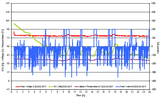

Running a two-shift operation was also tested, and Sonnenschein Lithium handled this scenario comfortably. Under this setup, the forklift was in operation from 6am until 10pm. The battery was charged overnight, and during the day it was charged twice for 30 minutes each. The chart below plots a two-shift operation.
Two-Shift Operation Chart

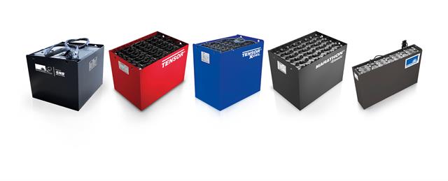

GNB Motive Power Battery Portfolio
GNB's market-leading range of forklift batteries are optimized to reduce total cost of ownership. Each is designed for particular applications, and GNB helps customers make the right selection for their needs. The company believes in offering a complete solution, and gives businesses the know-how and consulting to get the most out of the technology. Its range of chargers and accessories help to maximize the performance and lifespan of its batteries.
