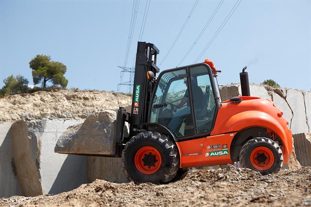

AUSA rough-terrain forklift at work

Xavier Perramon, products strategy manager for Spanish manufacturer AUSA, notes that considerable financial investment was required to meet Tier 4 standards. This year, AUSA will launch its 4-5 T range of rough-terrain and semi-industrial forklifts with 56kW Deutz engines fitted with Diesel Oxidation Catalysts (DOC). The engines not only meet Tier 4 requirements, but anticipate the mandatory 2017 normative.

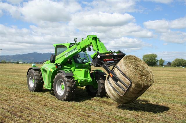

Italian telehandler manufacturer Merlo's Uliano Bellesia says that new Tier 4 engine adaptations and subsequent testing were expensive and time-consuming. Changes mainly affected Merlo's 55 kW to 130 kW telehandler range. Above 130 kW, only the ROTO (slewing turret) telehandlers required modification - these have been fitted with a selective catalyst system (SCT) which meets Tier 4 standards.

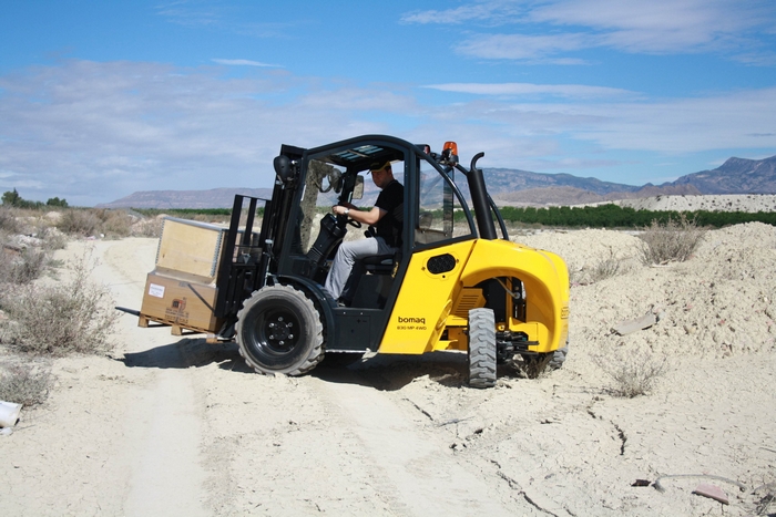

Spanish manufacturer Bomaq has redesigned equipment parts and integrated an additional postfilter burner to its rough-terrain machines. Managing director Antonio Martinez says that an additional issue arising from Tier 4 requirements is the use of electronics in the engines. "So far, we have used mechanical systems for fuel injection, but to reach the required new levels of regulation, use of electronics will be compulsory," he explains.

Bellesia says initial feedback on Tier 4 engine performance has been positive, but Merlo has had to mitigate price rises with offers of extra options. The company strategically timed the release of its new telehandler range so that increased prices could be cushioned by the novelty of new operational systems and options.

Martinez says the market is hard to predict, but believes rough-terrain forklifts have developed their own niche and will expand to other applications if manufacturers pay attention to the needs of users. He says the main markets for Bomaq continue to be in mining, agriculture and the military.
AUSA specialises in rough-terrain forklifts for agriculture, particularly in the fruit and vegetable sector where there is high demand for rough-terrain forklifts in the lighter, more compact 3T (6,000 lb.) two-wheel-drive range. Perramon says that globalisation has created 'new rooms' in countries in which to develop new markets. AUSA is keen to expand into the US and Eurasian horticultural sectors. He adds that AUSA's semi-industrial models, based on a rough-terrain chassis - but more compact, with higher diameter wheels and increased ground clearance - are gaining popularity in wood recycling, metal foundries and outdoor warehouse operations. These machines offer added value when the forklift has to push and pull pallets during loading/unloading of trucks.
Bellesia believes the telehandlers' versatility has protected them from any market changes. "In Europe, Canada and Australia, Merlo sells mainly into the agricultural sector. In the USA, it is the construction sector. The balance between the two sectors is our strong point. For the time being, sales are in line with the expected trend, " he says.

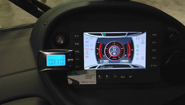

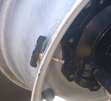

Roll-overs and tip-overs are an occupational hazard for rough-terrain forklifts and telehandlers. Uneven ground, slopes, dips, mud and unbalanced loads are the main dangers, but Luc Pirard, CEO for Belgian company Comatra, strongly believes that uneven tyre pressures are a hidden cause of many roll-overs. "We believe that this type of incident occurs far more often than acknowledged," he says. The Health and Safety Executive of the UK, the Construction Plant-Hire Association of the UK and the Telescopic Handler Association of Australia have all acknowledged that even a minimal 5% drop in tyre pressure can reduce stability and safe lifting capacity by up to 30%. "Because tyres deflect and distort under load, they have a significant effect on stability and load-carrying ability," Pirard explains.
Comtra tyre pressure sensor view monitor on dashboard
Comatra specialises in safety products for the materials handling industry and has developed a unique internal valve-mounted sensor system to monitor tyre pressure in rough-terrain forklifts and telehandlers. "Most rough-terrain forklifts and telehandlers are fitted with pneumatic tyres as they provide much better flotation on soft ground. The disadvantage, however, is that a pneumatic tyre can be easily damaged or punctured. The most critical situation is a flat or under-inflated tyre with a load in the air - altering the forklift or telehandler's stability and resulting in a possibly fatal tip-over." Comatra's pre-programmed sensors are mounted behind the rim, safe from dirt and other corrosive materials, and a monitor is fitted inside the cab. When the forklift/telehandler is turned on, tyre pressure is measured in less than a minute. The kit can be easily fitted by an experienced tyre-fitter.
