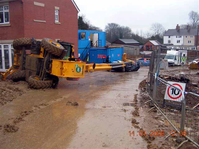

Fatal accident Banbury UK

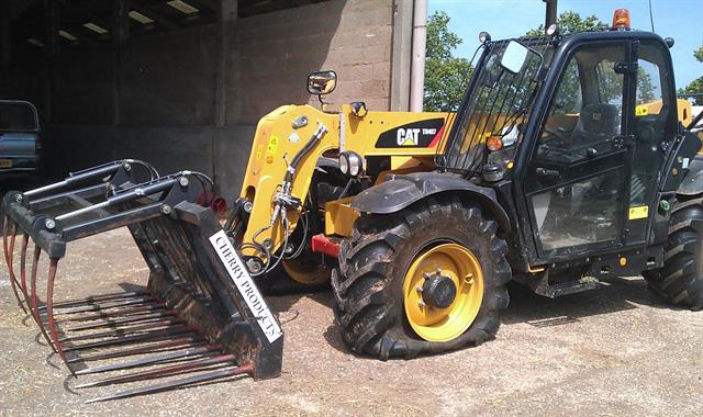

The downfall is that pneumatic tires are easily damaged or punctured by nails, screws and other construction materials. As a telehandler is being loaded and driven, the tires will also gradually loose air.
Deflating tires can be a serious safety issue, as the stability of the telehandler is sometimes affected.
Punctured tire
Punctured tire
In 2013, the UK HSE, the CPA and the Telescopic Handler Association of Australia acknowledge in their guide "Safe Use of Telehandler in Construction" that even a 5% drop in tire pressures can reduce stability and safe lifting capacity by 30 percent!
A flat or under-inflated tire on a telehandler with a load in the air alters the machine's stability and can cause fatal accidents.
Investigation into a fatal accident with a tipped-over telehandler in Banbury, United Kingdom, in 2008 showed that the incident was preventable if operating instructions in the machinery manual had been followed. Tire pressures were found to be lower than recommended.

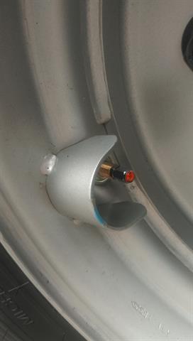

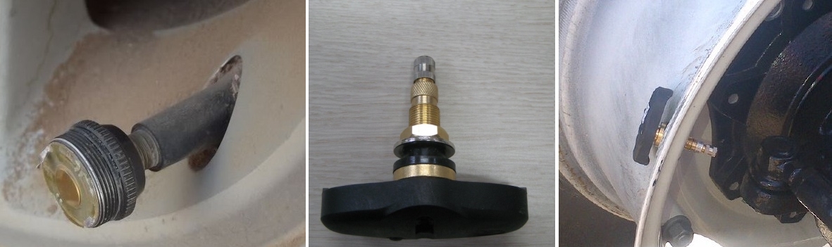

Unlike other systems on the market that plug into the tire stem dust cap, the pre-programmed sensors of the TP2AGRIC are mounted behind the wheel rim, keeping them safe from dirt and other corrosive materials or hazardous conditions that can cause damage.
L to R: Damaged valve cap end sensor, valve mounted sensor;  sensor installed on rim

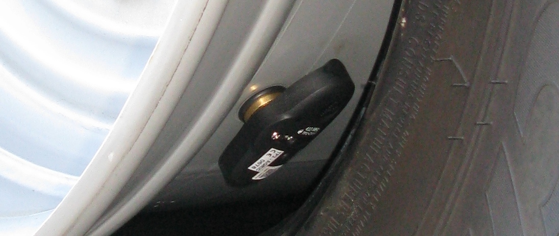

View of sensor rim inside

View sensor valve rim outside A
