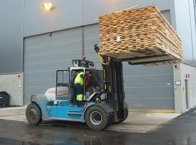

With over 60 years of experience, Scana Booforge
is a world leading manufacturer of large and customized fork arms for heavy forklift trucks. Scana Booforge is focusing in the heavier segment and the fork sizes are applicable to forklifts exceeding 8 metric ton in capacity. This focus assures the design and quality which a large fork requires in order to withstand the heavy wear and tear of an i.e. 18 or 28 metric ton truck.
The fork lift is no forklift without forks.

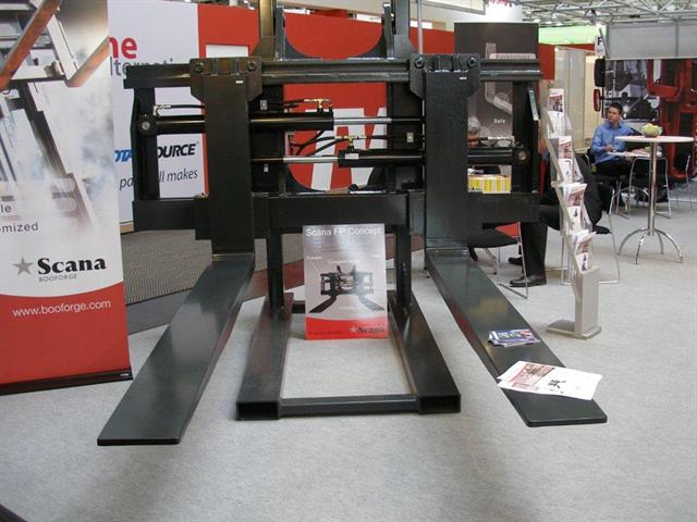

Firstly, you can divide the lifting forks into two main segments:
  • Click to enlarge image
    Forks for the lifting capacity range from 1 to 7 Metric Tonne. Within this segment there are many volume manufacturers of forks and the forks are very much standardized, i.e. a fork delivered on a Jungheinrich would also fit a Toyota fork lift of the same class.
    For this segment you can buy forks from many different wholesalers who are buying the forks from different manufacturer. Even Chinese forks are coming strong in this segment.

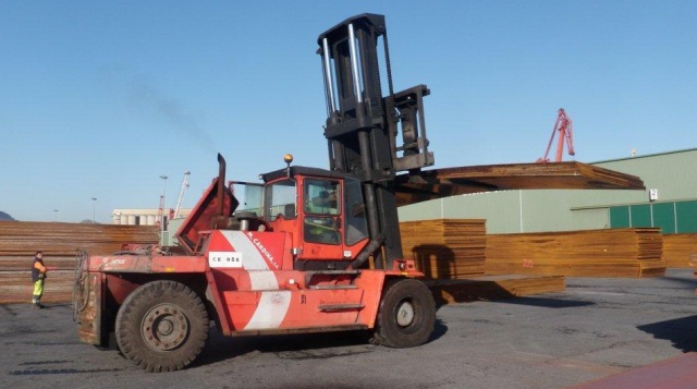

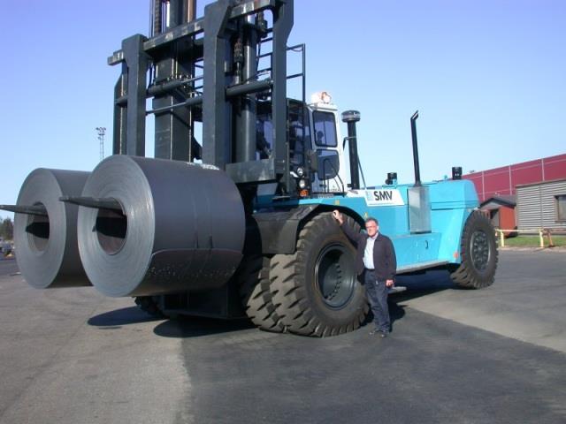

  • Lifting forks for fork lift trucks with capacities exceeding 8 Metric Tonne. This segment has a blend of classifications and customized forks, especially, when the lifting capacity exceeds 16 metric Tonne. In this segment the lifting tasks becomes tougher and more specialized. Therefore, the fork lift manufacturer is more careful to have their own lifting carriage and bracket setup on the forks, to assure that the complete fork lift truck withstand the certified capacity.
    Moreover, the fork becomes much larger and heavier than for smaller forklifts. For this segment there are only a few fork manufacturers who are able to provide forks suitable for heavier lifting tasks.

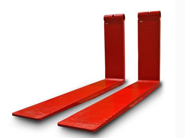

  • Production methods affect the price differently as it's very much depending of the volume. There are manufacturer who have a fully automatic production line where no human hand touches the fork until it's ready. And there are manufacturer who more or less make the fork like old fashion craftsmanship.
    Small forks are mainly produced from flat bar. The bar is then put into a production line where gas cutting, upsetting and bending are carried out.
    Large forks for heavier tasks, <12 metric Tonne, can both be produced from flat rolled bar or from single hammer forged billet. Yield strengths and impact resistance aren't affected but the fatigue resistance is different between hammer forged fork compare to rolled bar. This means that the thinner, forged fork better suits the task.
