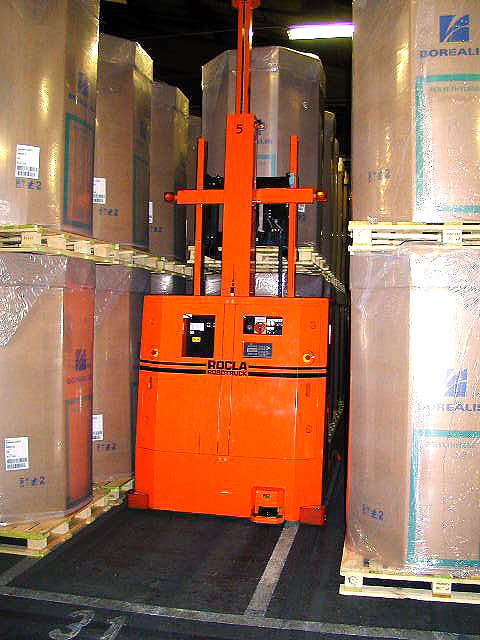

The 14 AGVs are transporting octabins from a production in to the storage and from the storage to dispatch area for lorries. The storage is a buffer store for the different production batches. There are two different parts in the storage; the largest parts contains normal catalytic processed polyethylene and a smaller part for PEX, the super clean polyethylene. This material can't be stored in low temperature.
An octabin is a special container - it is an eight edged cardboard cylinder placed on a pallet. approx 1100 x1100 mm. The octabin is filled with polyethylene granulate. The size of the octabin is standardized except for the height. The height is about 1.8 m. The weight varies, but 800 kg is the normal weight for the octabins.
Size of the warehouse?
The total area is 24 700 square meters and contains 15 231 octabin pallets today. The turn over factor is eight times a year. The flow has during the ten years been constant. In the storage lanes these cylinder are standing two by two in the stacking lanes.

It is load on load and we are searching the pallet tunnels with sensors in the forktips. The reason is that the bottom octabin can shrink by the load of the top octabins. The AGV fleet is made to run in 24/7 therefore the AGV:s are equipped with NiCd batteries for short charging time.

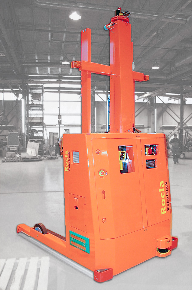

The AGVs have got new sensors because of better technology and accuracy.
The System has been developing from the start and still continues. The latest tasks were to increase the out feed speed and also to increase the available storage. The speed to make an out feed order has been reduced by 30%. The available storage has been increased by reducing the distance between the octabins in the lanes and also to use every square inch by decreasing areas that earlier was blocked by pillars and other reasons in the ware house. All these actions had to be implemented carefully step by step because of the complexity in the storage. The consequences of an action can take several weeks to discover and even more time to remedy.
These efforts have paid off; the transport efficiency has increased over 50% and the storage has increased with 1000 extra locations.
The Borealis facility has been popular to visit during the years and for several reasons. One of them is reference visits for Rocla customers. Students have visited the site. Danaher-Motion has used the site for testing equipment in real life and also as reference visits for customers. The 17 year old system has been improved already from the beginning and has never worked as good as now. It will be improved in the future as well. Borealis plans to use the system for the next ten years. There are no competitive alternatives versus AGVs. The warehouses will remain and the AGVs seem to be made as tanks, it is a pity that the electronic equipment can't live forever.
