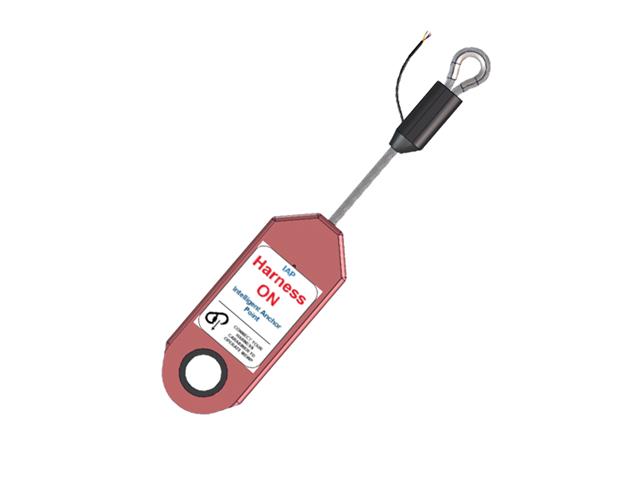

Harness ON™
To further improve operator safety, add Harness ON™ to the fall protection kit. Harness ON™ is an intelligent anchor point that is permanently shackled to the MEWP’s anchor point and is electronically wired to the machine’s function controls. Until the operator clips a carabiner to the inductive ring of the Harness ON™, effectively connecting their harness to the machine, the MEWP won’t function. It’s an easy-to-use solution that doesn’t affect the operator’s work but has a big impact on safety. Moreover, Harness ON™ complies with EU and ANSI standards and is compatible with all machines.
Turn to TVH for this easy-to-use solution with a big impact on safety because we are the exclusive worldwide distributor of Harness ON™.

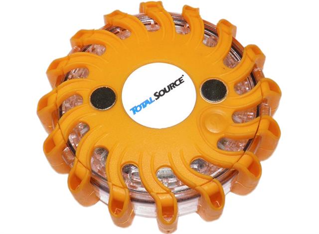

Warning Lights
Mobile elevating work platforms are ideal for working in hard-to-reach places. However, this means that the machine sometimes has to be parked in less-than-ideal conditions, such as bad weather or along a busy road. To make sure the MEWP stands out, it’s advisable to use warning lights.
The lights are magnetic, so they can be quickly and easily attached to the machine. TVH has lights in its range with nine different flashing patterns for extra visibility.

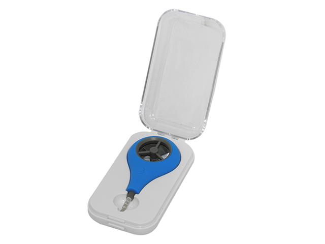

Wind Meter
MEWPs for outdoor use are designed to withstand wind speeds up to a certain maximum. This maximum is always specified on the machine, as it’s important that the mobile elevating work platform isn’t operated at wind speeds above the maximum. Otherwise, this could lead to instability or, in extreme cases, could cause the machine to tip over.
That’s why wind speed should always be measured before entering the platform. This can be done with a wind meter, also known as a wind gauge or an anemometer. Modern wind meters come with a Bluetooth connection and a smartphone app, and can usually display more than just the wind speed and direction. Some types also measure the temperature, humidity and air pressure. TVH offers several types of wind meters, as well as magnetic tripods and self-levelling mounting brackets for secure mounting.

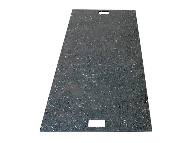

Ground Protection Mats and Outrigger Pads
Not only wind speed affects the stability of mobile elevating work platforms, but the surface on which the machine is standing or being driven also plays a crucial role. In case of soft or uneven terrain, ground protection mats can provide a safe and solid base for the MEWP to travel over. These mats are also useful to protect the delicate zones that normally aren’t accessible with heavy equipment, such as golf courses, festival grounds, etc.
Another way to keep mobile elevating work platforms stable is with outrigger pads. They distribute the ground pressure better, which prevents the machine from slipping and sinking into soft ground. But outrigger pads can also be handy indoors to protect floors, as some types have an integrated non-marking rubber base.

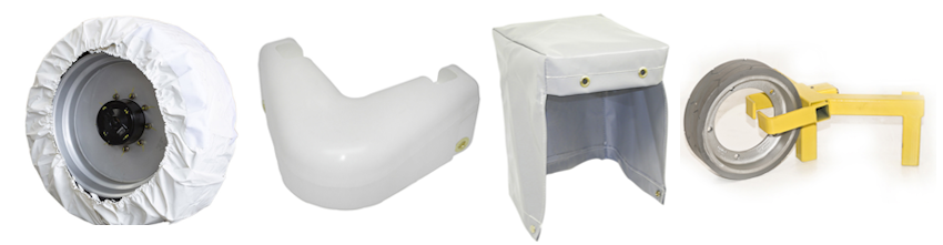

Wheel Covers
To prevent damage to particularly delicate floors, for instance in showrooms and exhibition halls, or in older buildings during renovation work, it’s best to cover the wheels of the mobile elevating work platform. Important to know, however, is that intensive use of wheel covers will reduce their lifespan.
Corner Protection
Not only the floor can be delicate, but surrounding structures may also need extra protection. In this case, it’s a good idea to install corner protection on the platform rails. These guards are made of soft rubber and prevent damage to both the environment and the machine.
Protective Covers
Bad weather can wreak havoc on the steering control unit of mobile elevating work platforms. But with a water-resistant protective cover made from PVC-coated fabric with polyester tissue, weather elements don’t stand a chance.
Security
Protecting the equipment also means securing the MEWP against theft. This can be achieved with a wheel clamp, equipped with a numerical safety lock with a four-digit code. TVH has both a small and a large model in its range. The former is suitable for a tyre width of 160 mm to 360 mm, the latter for 195 mm to 420 mm.

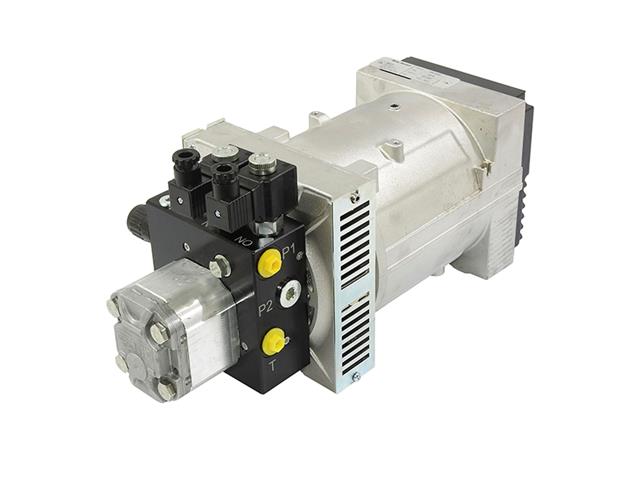

Hydraulic Generator
When working at height, it can be difficult to have a power supply for small and heavy power tools. A hanging cable reel is far from safe and an external power supply is rather expensive. The solution is a hydraulic generator, which can be connected to the hydraulic circuit of MEWPs to provide all the power required. Hydraulic generators are available in a range of electric potentials, including 110 V and 230 V.

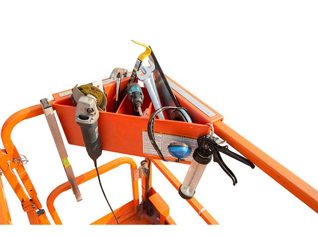

Aerial Tool Bin
If there’s a chance that the MEWP operator will need a lot of tools and parts when they’re in the air, an Aerial Tool Bin could come in handy. This accessory can be attached to the corners of the platform’s railing and is strong enough to hold all the items the operator will need.
