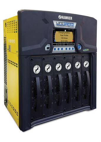

HAWKER has a long tradition of more than 30 years of high-frequency charging technology and innovation. The LIFESPEED MOD3 high-frequency, smart charger series combines the company's charging expertise with the advantages of modular charging.
Equipped with the patented AccelRate® technology, LIFESPEED MOD3 modular chargers illustrate the continuing growth of HAWKER's modular charging revolution.
Enhanced Flexibility of 3 Charging Profile Options
LIFESPEED MOD3 modules are the most flexible in the industry by operating as a fast, conventional, and opportunity charger. It's three chargers in one! LIFESPEED MOD3 chargers provide optimum charging, peak efficiency, and non-stop power while reducing charging costs and energy demands.

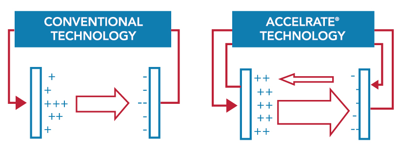

Diagram of Patented AccelRate Discharge Circuit
AccelRate Fast Charging Technology
The LIFESPEED MOD3 charger line delivers outstanding fast charging capabilities. Utilizing the patented AccelRate technology, LIFESPEED MOD3 chargers feature a unique charge algorithm that can recharge batteries 3 to 5 times faster than conventional chargers. This algorithm reduces the natural resistance of the battery by incorporating short, low-energy discharge cycles at precise intervals. This process lowers the build-up of charging ions around the battery plates, allowing a more even distribution of active ions over the entire charging area. This discharge cycle increases charge acceptance by the battery, thus reducing excessive heat generation and allowing a higher charging current to be applied and maintained. The result is a fully charged battery (100% amphere hour return from an 80% DoD) in just 2-3 hours.

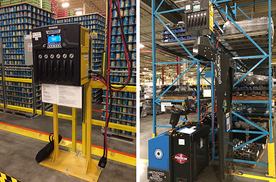

LIFESPEED MOD3's compact size allows for a variety of placements within warehouse operations.
The LIFESPEED MOD3 includes an opportunity charge profile that returns capacity to the battery during breaks without excessively gassing the battery. The opportunity profile can be set either manually using front panel menus or automatically while using HAWKER's Battery Boss® WC wireless, smart-data diagnostic device. When coupled with the compact BBWC device, the charger will automatically adapt to battery, AH capacity, and temperature. Whichever profile is selected, the charger will automatically charge a range of battery voltages and in IONIC will automatically adjust for a wide range of battery AH capacities.

As Portney mentioned, an intrinsic benefit of the LIFESPEED MOD3's modular design is scalability. Offered in 6-bay and 12-bay cabinets, these chargers allow for modules to be added or removed in response to customers' changing power needs. The LIFESPEED MOD3 chargers can be configured for a wide range of 3.5 kW modules - up to a maximum of 12 modules. This allows customers to scale their charging power to meet their operational demands.

Installation of each power module is fast and simple.

The LIFESPEED MOD3 chargers feature a light, modern design. These charger models can be shelf-mounted or wall-mounted (6-bay cabinet) during installation. The extra-large (7-inches), color-changing TFT display screen allows the operator to observe the charging status from a distance. The display screen incorporates multi-language support, easy-to-navigate controls, and a real-time clock. And, the charger's accessible USB port makes downloading charging history easy and fast.
