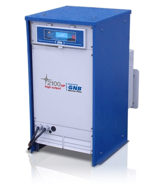

GNB has a market-leading range of battery chargers, including GNB 2100 HP, the versatile all-round charger designed for high-performance, energy-efficient charging. It provides highly efficient power conversion, which reduces power consumption and energy costs. It is also available in the 2100 Weatherproof version, which protects from debris, weather and other externalities. This is used to charge ground support vehicles at airports, and in the metal industry, where filtering and dust-proof housing are required.
