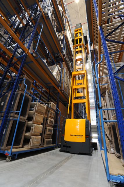

The EKX 515 uses RFID transponders embedded in the warehouse floor to navigate its route around the store.

The new store features nine aisles of narrow-aisle storage - with a top beam level of over 12 m (39 ft.) - served by guided Jungheinrich EKX 515 electric order pickers/stackers.
The EKX 515 uses RFID transponders embedded in the warehouse floor to navigate its route around the store. The warehouse management system (WMS) issues picking instructions to the truck, which then automatically takes the shortest route to its destination.
Jungheinrich estimates that the RFID-based warehouse navigation system technology enables 25% more efficient throughput than traditional narrow-aisle truck technology.
