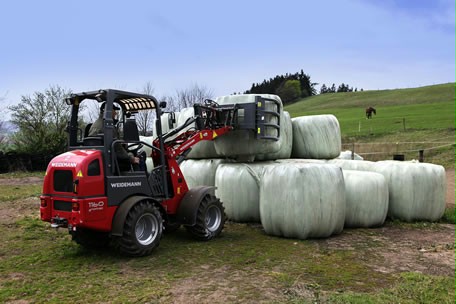

Weidemann GmbH is starting series production of what it says is the first fully electric farm loader, the eHoftrac, in Europe. The truck's drive technology comes from Linde electric forklifts.
The eHoftrac was designed to achieve the same performance as the combustion-engined model without being significantly more expensive.
"That presented a number of technical challenges," explains Jan Prechel, head of vehicle development at Weidemann. "The electric motors have to fit in the existing compact installation space for diesel engines and still produce the same performance. In addition, the software for the eHoftrac has to be modified to make the vehicle handle more dynamically, especially when reversing.
"During development, we compared the solutions of different suppliers and, in the end, decided in favour of Linde."
Working with Linde Material Handling's Electronic Systems & Drives (ES&D) division in the northern autumn of 2013, Weidemann produced a first prototype that satisfied all the technical requirements and was immediately operational after assembly.
The drive technology is provided by system components of Linde forklifts - traction motors and inverters stem from a Linde reach truck and the pump motor from the standard series of electric forklifts. The developers adapted the system communication software to the loader's performance.
For charging technology, Weidemann deployed a 48 v lead battery that is commonly used in agricultural applications. As a result, the eHoftrac can be operated continuously for two to three hours, depending on the operating conditions, after which the battery can be charged at an electric socket with the aid of an external charging unit.
