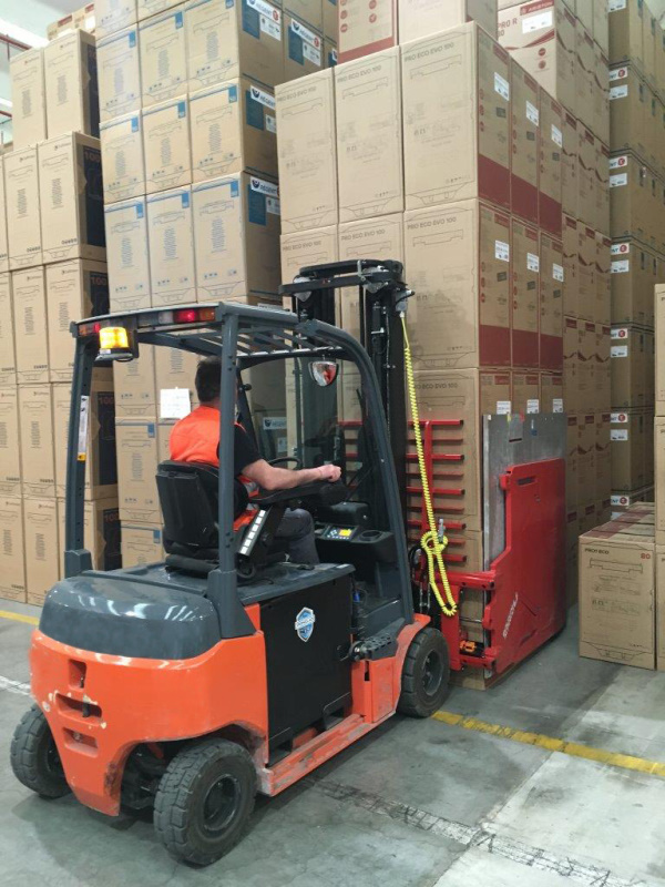

Oscillating (KS-C) and rigid arm (KS-CF) clamps equipped with Easy-MOVE System.
Automated Clamping Pressure Control
Bolzoni Auramo has come up with an outstanding proposal of integrated Laser Sensors Solutions for the automatic clamping pressure control reducing to zero the responsibility of truck drivers for wrong handling and squeezing. "The amazing fact is however that nowadays, thanks to the new technology, it's possible to do this granting the same ease of use of a conventional clamp," says Vittorio Lucchini, Carton Clamps and White Goods Logistic Product Specialist of the Bolzoni Group.
The Easy-MOVE System fitted on KS-09CNA carton clamp, at a leading appliances manufacturer.
The Easy-Move Intelligent System uses laser sensors installed in a fully protected position on board of the clamp. The system is driven by the number and dimensions of the unit loads (boxes) between the arms. Through these inputs the correct clamping pressure is set by means of a proportional pressure relief valve.

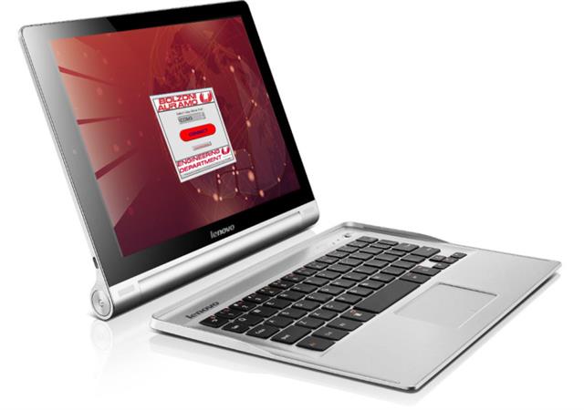

The micro-control can be connected via USB to Bolzoni configuration tablet and through an easy procedure (touchscreen based) the operator can adjust the handling and load parameters, recalibrate the sensors if necessary, associate the opening ranges to the required pressure levels and possibly recalibrate them in case of introduction of new loading scheme.

New Option: Tablet
As standard, all clamps are ex factory preset with load and pressure parameters agreed with the customer.
The clamping load configuration has changed? You can update load parameters with the tablet, available as option.
In case load parameters have to be updated, because of load dimension or configuation changes, the end user and the truck dealer have two possibilities:
  • to exploit expertise and capability of Bolzoni Auramo Meyer personnel to make final adjustments and/or future modifications on pressure parameters on site,
  • or to become completely independent and autonomous for clamp set up change with a dedicated Bolzoni Auramo tablet.
With a dedicated tablet, supplied by Bolzoni Auramo, the end user can adjust pressure parameters through an user friendly interface: adjust opening range, pressure values, to calibrate sensors and to set the clamp in manual mode.

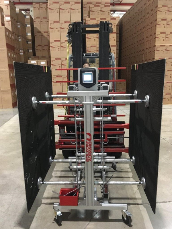

Check the 4 pad corner pressure distribution. Ask for the Force Tester available at customer premises.

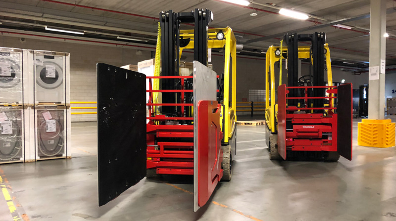

Wide Range of Cartons: Wide Range of Clamps
The Bolzoni Auramo carton clamps range is the result of a great commitment and investment in providing an extensive industry solution targeted to generate tangible savings and assets for the end user.
Each product or load schema requires an individually adjusted clamping force and pads configuration. This is the reason why Bolzoni Auramo designed a wide range of carton clamps customized for each specific end user's demand including:
  • Rigid arms version
  • Single and double oscillating version
  • Tilting version
  • Rotating version
  • Single oscillating version with Force Balance

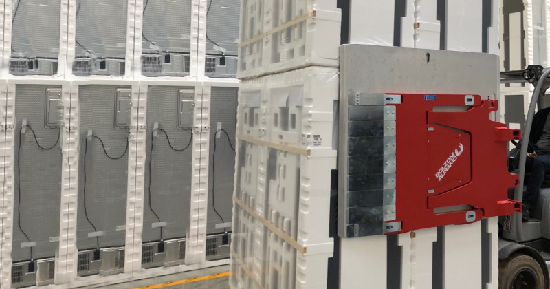

The Force-Balance Pad
Bolzoni Auramo patent pending Force-Balance Pad.
This patented Bolzoni Auramo system allows perfect distribution of the clamping force over the arm's surface thanks to the user friendly registration of four thread screws that impact on the arm camber. This system has been tested and implemented for a long period in cooperation with one of the main distribution centers in Italy working 24/7. This pad configuration performed to be more resistant to mechanical deformations, in comparison to most of competitors' clamps after a long period of use.
Complete Set of Pressure Control Devices
Bolzoni Auramo has a complete set of pressure control devices, such as the Four Point Clamping Force Tester. All carton clamps are tested as standard ex factory, and delivered with a defined set up of a single imposed pressure value.
