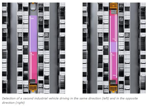

S3000 Anti Collision: Operate more than one vehicle in a narrow aisle for the very first time
In mobile applications, the S3000 Anti Collision offers by far the largest range for a field where safety is key: 15 meters. A protective field is used to safely detect oncoming forklifts in narrow-aisle applications and reduce their speed before a collision occurs. The S3000 Anti Collision can be relied upon to detect a reference target on the oncoming vehicle at a distance of up to 15 meters away. This means that - for the very first time - it's possible to operate two forklifts at high speed in a single aisle, offering maximum results with a high level of system throughput. Dynamic field switching is a further function that facilitates a high degree of throughput. At the same time, the S3000 Anti Collision monitors a protective field of up 7 meters to detect human presence.
No compromise on safety

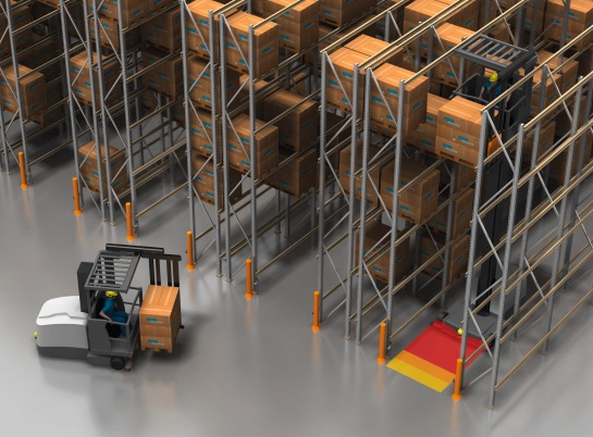

As a result of spatial restrictions in the aisles, shelving systems that are accessed using industrial trucks do not always conform to a minimum distance of 0.50 meters between the shelving units and the vehicle or load to be transported. Passages of this size between shelving systems are referred to as narrow aisles. It's not possible for operators of industrial trucks in narrow aisles to avoid oncoming vehicles. In order to ensure personal safety, DIN 15185-2 requires operators to take technical and organizational action.
Detection of a second industrial vehicle driving in the same direction
The "reliable collision protection field" is an auxiliary function of safety laser scanners intended to prevent industrial trucks from colliding in narrow aisles. Unlike conventional safety functions that offer personal protection depending on whether a human presence is directly detected, this function detects a vehicle in the surrounding area and so, by avoiding collisions between two vehicles, indirectly prevents harm from coming to individuals.
The high relative speed of two vehicles that are travelling toward each other makes it necessary for the collision protection field to have a large scanning range. In this case, a protective field with a scanning range of 7 meters is no longer good enough. From a user perspective, the objective is to increase throughput as a result of the ability to operate two forklifts in a narrow aisle at high speed.
