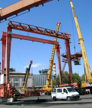

Cargotec Argentina's solution for BACTSSA involved increasing the length of the RTGs' columns by 2.9 metres (9.5 feet) by installing column extensions.

BACTSSA had been operating the two Kalmar RTGs for 10 years, before it awarded Cargotec Argentina a contract to increase the lifting capacity of the machines from 1-over-4 to 1-over-5 containers high.
The modifications to the RTGs required thorough structural and mechanical calculations, and the design has to meet international standards.
Cargotec Argentina managing director Marcelo Massa says modifying RTGs is a good solution when container handling capacity has to be increased quickly and cost-efficiently.
"By extending the container stacking height, capacity can be increased considerably without taking up more space in the terminal," Massa explains.
The solution involved increasing the length of the RTGs' columns by 2.9 metres (9.5 feet) by installing column extensions manufactured by local suppliers. Cargotec experts closely supervised the manufacturing of the column extensions.
Cargotec Argentina's staff of engineers, supervisors, mechanics and electricians, completed the RTGs' modification in less than two months.
