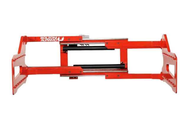

Intelligent Carton and Appliances Clamp i - move model,
the new and innovative clamp representing the Bolzoni Auramo solution to the excessive clamping problems.
Designed for safe and damage-free handling, the most common application fields are in the white goods and high-volume carton boxes handling.
  • Load volumetric detection through electronic sensors on the clamp and automatic clamping force adjustment through dedicated software and control unit.
  • Very rigid frame structure with single piece double "T" profile. Wide visibility window thanks to new vertical plates position at the extremity of the frame. Narrow vertical plates. Superior visibility through the frame grants safe and easy handling operations.
  • New aluminium arm design with new high friction rubber lining, special Bolzoni design.
  • New check valve for simple and precise arm synchronism, easy fitting, new position in the upper profile shadow granting valve protection and high visibility of the structure.
  • New fixing system of the sliding pads to relief stress.
  • New self aligning cylinder fixing to avoid breakage.
