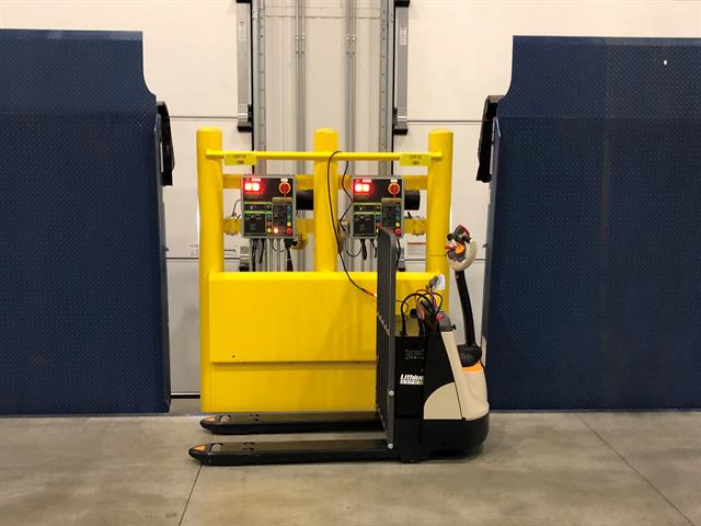

Determine whether there are opportunities for ad hoc or scheduled charging
The long cycle life means an LFP battery can be installed and remain in the equipment until it is retired (i.e. no battery swaps for the equipment life). More importantly, since LFP chemistry can accommodate high power delivered to and from the battery, a depleted LFP battery can accept a full charge in one hour. This charge does not need to be delivered in one charging session. Rather, it can be delivered throughout the shift when the operator has down-time (for example, a break or lunch). Since LFP batteries can accept partial charges between use and a depleted battery can be charged within one hour, Li-ion is the optimal chemistry for opportunity charging.
