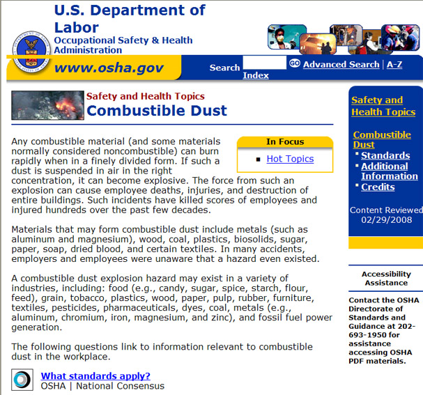

The US Occupational Safety and Health Administration (OSHA) announced in March 2008 that it would be targeting inspections of combustible dust industries. This special emphasis arises from the number of deaths attributed to explosions caused by the ignition of dust concentrations.
Dust explosions are not unique to the United States. The hazard is universal. Much of the information provided in the OSHA Resources on Combustible Dust is applicable to any country. Where specific US legislation or consensus standards are given, non-US readers will find similar legislation and consensus standards in their own OHS/OSH/OSHA regulations.

Finally, here are links to some OSHA Resources on Combustible Dust
* Fact Sheet [PDF 790K]
* Safety and Health Information Bulletin
* Safety and Health Topics Page
