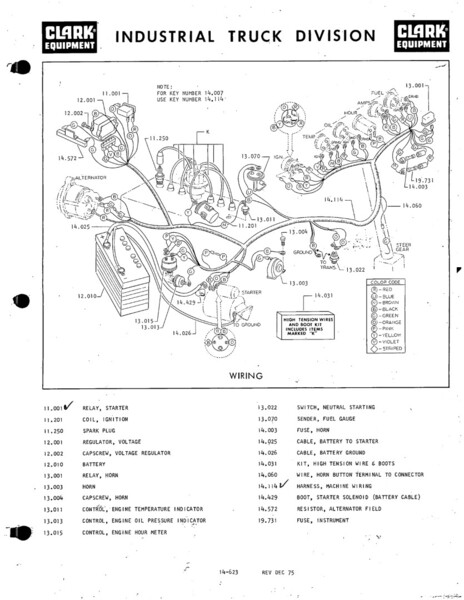

I'm in need of a wire diagram as well for a C500-H30. The one on this thread is exactly what I need but it's to blurry to see the little numbers. Can someone send it to me. Thank you

Basic Schematic for C500.
