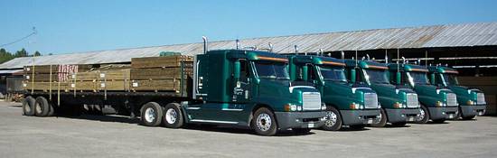

Specialised wood-product supplier Cox Industries Inc is using radio frequency identification (RFID) technology to improve efficiency in its forklift and shipping operations.
In an initial location in Blackstone, Virginia, the family-operated business replaced manual tracking processes with RFID and is experiencing accuracy of about 99% in shipping orders for wood products to building supply dealers and specialty distributors.
