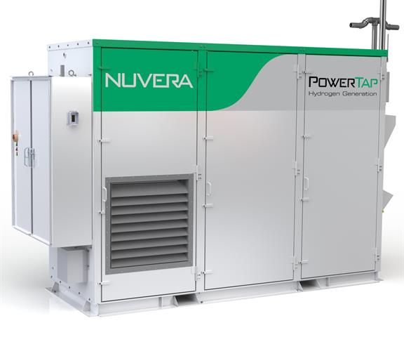

Example of an on-site hydrogen generator, the PowerTap® PT-50, capable of 50 kg/day hydrogen production.
Realizing the benefits of fuel cells depends on a secure and dedicated source of fuel. Nuvera's PowerTap® is a hydrogen generation appliance that enables the shift from batteries or engines to fuel cell power sources. Hydrogen, used to power fuel cell battery replacements like PowerEdge, is generated from natural gas and water on-site. The PowerTap generator is located outside the facility, freeing up valuable floor space previously taken up by the battery room and battery washing station. Hydrogen fuel dispensers are installed indoors at locations convenient for truck operators. Hydrogen dispensing is fast, typically just one to three minutes, and operators can refuel anytime, regardless of charge cycles. The result is efficient, zero-emissions operations. Customers using fuel cell battery replacements have increased fleet and labor utilization as a result of gained operational efficiencies, increased indoor facility

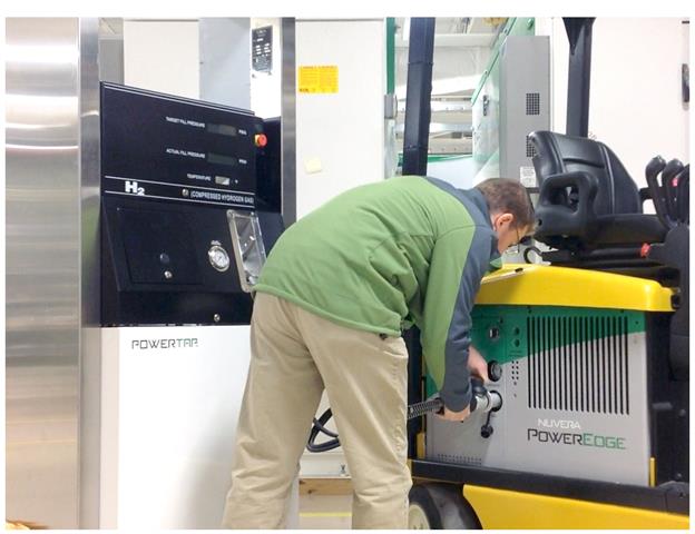

Fast fueling of a PowerEdge® in a Class I Yale® truck
space through the reduction of indoor power related equipment, and increased truck life by eliminating voltage decay and the resulting vehicle stress on electrical components. The shift in energy use enabled by hydrogen also allows facilities to eliminate peak demand electricity charges.

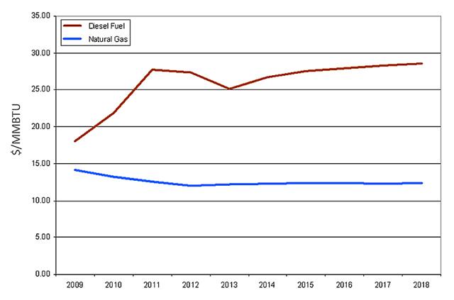

The increased use of natural gas for transportation, especially for medium- and heavy-duty trucks, is a major trend favoring users of hydrogen for industrial motive applications such as forklifts. A number of factors are driving natural gas vehicle fuel adoption, including a wider availability of natural gas, financial incentives from federal and state governments to promote the adoption of cleaner fuels, and the increased availability of natural gas refueling infrastructure in the U.S.(3,4) Natural gas used for vehicles is forecast to cost less than half of diesel in the next three years, as shown in Figure 1. The environmental benefits of natural gas versus diesel compelled many Class 8 tractor-trailer operators at the twin Ports of Long Beach and Los Angeles to switch to natural gas when tighter emissions regulations went into effect in January 2012.(5)
Figure 1: Diesel and Natural Gas Price Spread Forecast for On-Road Use.(6)

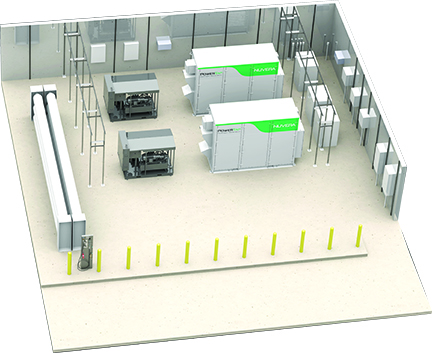

Rendering of a typical outdoor PowerTap pad site. This example measures 51 ft x 56 ft (15.5 m x 17 m), with plenty of room for modular system expansion with a third generator.
