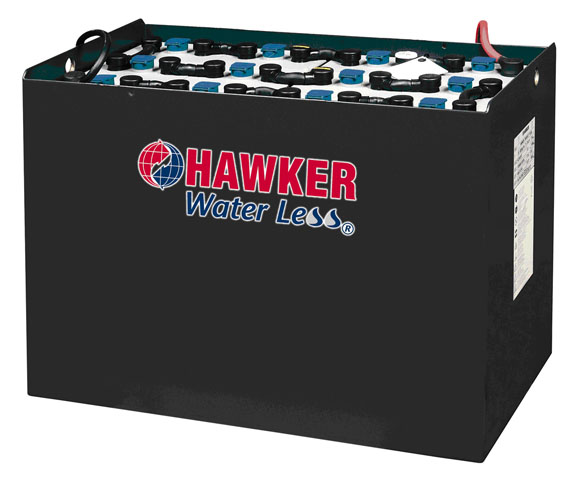

Hawker Water Less
This product is based on our proven, robust PzS technology flooded batteries but with the advantage of increased topping-up intervals. This can be four weeks when used with 50Hz charging technology (CF 1.20), eight weeks when used with Hawker HF chargers (CF1.10) which can be extended to 13 weeks with the optional extra of electrolyte circulation (CF 1.07).
Labour savings for less frequent topping-up are between 60%-90% and savings in electricity of up to 25%.

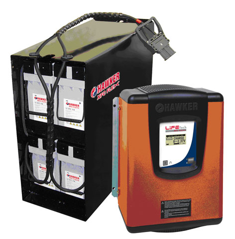

Hawker XFC Flex
This product is totally maintenance free, uses our Thin Plate Pure Lead (TPPL) technology and is unique in the way it can be operated due to its design and very low internal resistance. You can discharge the battery as required, you can safely opportunity charge the battery during coffee & lunch breaks, shift change-overs and whenever the truck is idle. You can safely operate the battery in a partially charged state and a full recharge from 60% DOD takes around three hours.
In addition to the increased flexibility in the use of your trucks, you also save on recharging costs as the Hawker Lifetech XFC charger used with this battery has a charging factor of 1.03!
Hawker XFC Flex is currently available for Class 3 pallet trucks, floor-care machines and other applications that require battery size up to 24V350Ah.
