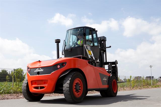

Linde H160 with rotating cabin
Colin Flint, head of marketing at Linde's heavy truck division, believes that heavy lifting tasks require that manufacturers invest in a degree of engineering resource in-house not needed by smaller forklifts. "Over 95% of all forklifts manufactured by Linde heavy truck division are bespoke units built to individual end-user requirements," he says, adding "this doesn't happen in the under 10T range".

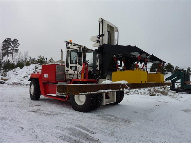

Dan Johansson, area sales manager at Svetruck, explains that since manufacturing began in 1977, his company has only manufactured forklifts 10T and over, exploiting what he calls a very strong and expanding niche market. Furthermore, there has been a conscious decision by Svetruck to make all components in-house. This, he believes, makes Svetruck one of the few - if not only - forklift manufacturers making their own components in the world today, allowing the company complete control over quality, reliability and design. Svetruck heavy forklifts are "practically built by hand" and, for this reason, the lead time can be quite lengthy - up to nine months. A long lead time is typical for most heavy forklift manufacturers, and customers understand and are willing to wait for delivery of such a costly investment, he adds.

Johansson has a similar story with Svetruck's hydraulic pipe clamp. The original clamp, with mechanical stop, was designed in collaboration with Coast Centre Base - an oil and gas supply company with bases throughout Norway and the North Sea. CCB needed a faster, more convenient and safer method of transporting gas and oil pipes on and off the supply ships. Previously, pipes were transported using three men, cranes and slings. It was dangerous work, with the risk that the pipes, up to 12 m in length, could roll forward. Svetruck designed the first pipe clamp in 1991 and has recently released new versions with hydraulic stop and in 2011 as an optional attachment.

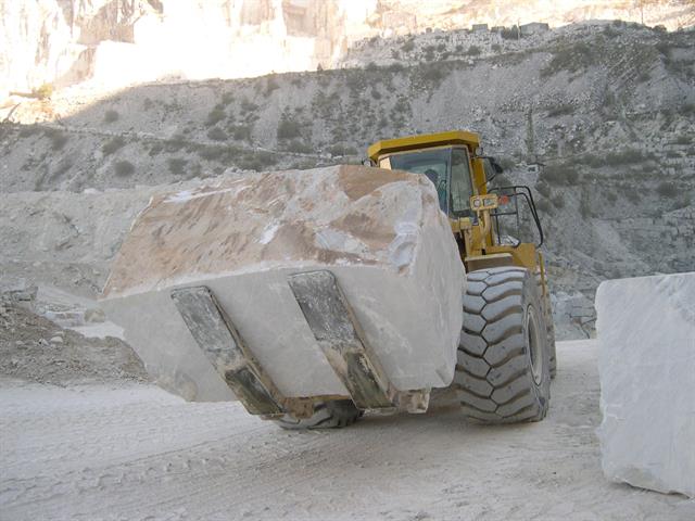

Safety in heavy forklifts is a recurring theme - the bigger the machine, the heavier the load, the smaller the margin for fatal error. Clark Equipment's Omega E-series has been designed with safety in mind, with one of the highest tip-up safety factors in the industry. The Omega range is built specifically for specialist applications. A spokesperson for Clark equipment Australia says that the Omega range has a core group of heavy forklifts with specialised variants available for specialist applications.

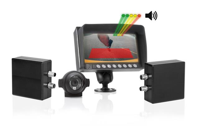

Most heavy forklift manufacturers need to source parts and accessories from independent suppliers, so certain companies become intrinsic to the functionality, efficiency and safety of heavy lift forklifts. Dutch company, Orlaco designs and manufactures camera systems for heavy industrial equipment as well as supplying a number of OEMs. Orlaco cameras can be fitted to the rear of a forklift to improve rear-views, but can also be mounted inside container handler spreaders. The camera in this position allows the operator a clear view of spreader and twistlocks, enabling him to safely guide the twistlocks into place. A system of cameras mounted around the forklift provides the driver with a clear line of sight around and behind the forklift; all the camera views can be directed to one monitor mounted in the forklift cabin. Laurens van der Rijt, Orlaco's business development manager, explains that close co-operation with heavy forklift OEMs has had a major influence on camera design. Most recently, the company released a radar system in response to end-user requests. The RadarEye alerts the driver audibly and then visually via the inside monitor when there is an object in the forklift's 'danger zone'.

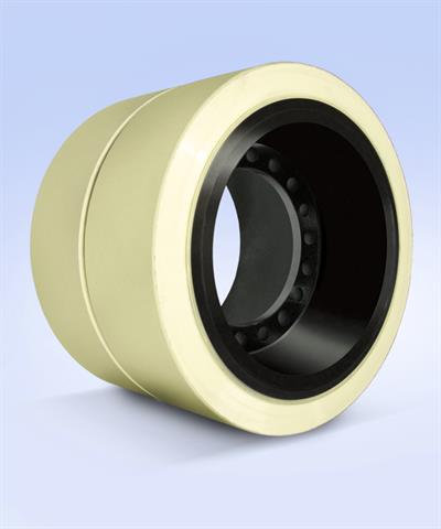

Tyres are, of course, an essential component of any forklift, but on heavy forklifts, they play a significant role in performance. Changing a tyre on a 50T forklift can be both costly and time-consuming. Hank Le Meur, CEO of Superior Tire and Rubber Corporation, explains that heavy forklifts require different tyres to smaller machines because of the very high ground pressures that they generate through low speeds and greater weight. For this reason, heavy lift forklifts require tyres with a different compound. Superior's Cushothane XL tyres offer extremely high cut-and-tear strength, minimising tyre "chunking" (chunking happens when a patch of tread has loosened and is torn off by centrifugal force at speed). Heavy forklifts have the potential to outlive their original technology, making parts such as tyres difficult to source. Superior has an in-house library of wheel/hub combinations, which means it can rebuild or manufacture new wheels without OEM specifications.

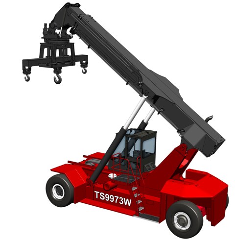

Taylor TS9973 reachstacker equipped with attachment for transporting wind tower and parts
