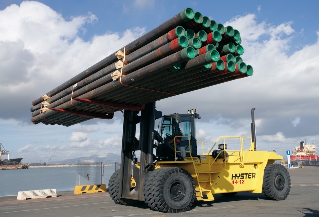

Adaptalift Hyster is proud to announce the next generation Hyster 36-48 tonne series of forklift trucks. These trucks offer maximum flexibility for a range of heavy-duty applications and are available either with standard forks, or a fork-mounted, removable 20'-40' telescopic container spreader. These heavy duty forklifts are ideally suited to steel, quarrying, mining and port applications and have the benefit of Tier 4i/Stage IIIB compliance and low fuel consumption.
The series consists of seven models, with the 36-40-44-48 tonne (@ 1,200mm load centre) models also being available in an "S" (short) 5.38m wheelbase version. These versions are some of the most compact machines in this capacity available on the market, ideally suited to various heavy industry sectors.
Fast travel speeds and lifting speeds help contribute to reduced operating costs during a shift with class-leading lift speeds of up to 0.385m/sec.

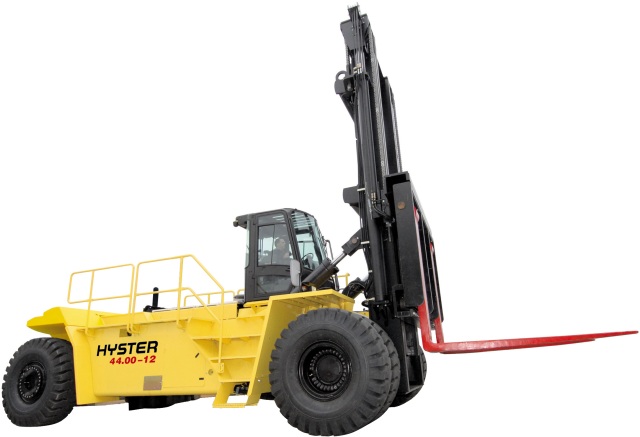

Powertrain
The new Tier 4i/Stage IIIB 36-48 tonne capacity forklifts feature the Cummins QSL9-350hp engine (The Cummins QSM11, 300hp and 335hp versions remain available for Tier 3 compliant trucks). Rated power for the QSL9 is 261kW (350 hp) @ 2100rpm, maximum torque is 1491 Nm (1100 lbs-ft) @ 1500 rpm and maximum power is 276 kW (370 hp) @ 1900rpm.
The advanced auto-shift transmission available with this new engine option is the TE-27 series, with the TE-32 available as an option. There's a protective forward/reverse shifting lock-out, a transmission protection system and a heavy-duty drive-axle featuring wet disc brakes.

Low cost of operation
In service, the H36-48XM(S)-12 offers a number of standard features to help the customer effectively manage truck operating costs. For quick and easy service access, the cab features a powered side-tilt facility in combination with quickly removable lightweight aluminium floor plate sections. Large 18.00x25 tyres (available as Bias pneumatics or Radial pneumatics) offer improved tyre life and lower running costs.
