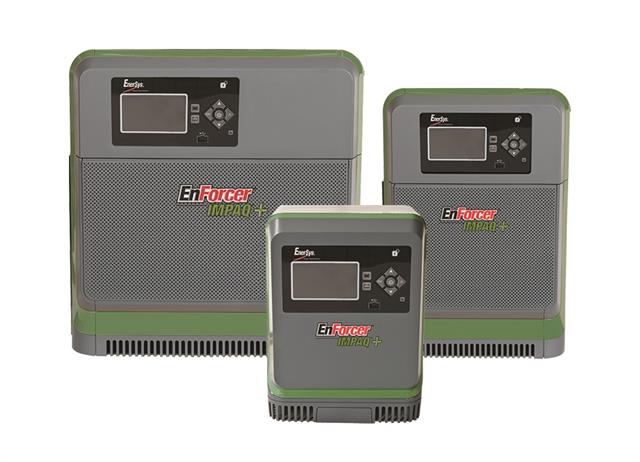

EnForcer® IMPAQ™+ chargers by EnerSys

  • High Frequency (HF) chargers, such as EnForcer® IMPAQ chargers, feature a flexible, ultra efficient (over 90 percent) design to accommodate a wide range of charging profiles, from standard flooded and VRLA to cold storage and opportunity charging. Typically, these are the only chargers that meet the California Energy Commission (CEC) energy efficiency standards, as required for chargers placed in California and Oregon.

Modularity adds another element of flexibility. EnForcer® IMPAQ chargers by EnerSys® feature modular construction that adapts to a wide range of battery capacities, allowing potential reduction of the number of chargers in a fleet. Modules can be added if battery capacity changes, and the three-phase model can charge at multiple voltages. Multiple modules also may be configured to provide redundancy in case of failure, providing continuous charge until a replacement is installed.
The Exclusive IONIC Profile: A Breakthrough in Charging Efficiency
As technology advances, charge profiles are being developed to further enhance the quality, length or efficiency of the charge. The EnerSys® EnForcer® IMPAQ+ charger with the exclusive IONIC profile advantage enhances all three features to deliver vast improvements in forklift battery life compared to other chargers.
The EnerSys® EnForcer® IMPAQ+ charger with the exclusive IONIC profile advantage stands out from the crowd as the only industrial charger to offer four distinctive evaluation periods and continuous battery condition diagnostics throughout the entire charging cycle.
The IONIC profile advantage features a patented charging algorithm, sophisticated battery diagnostics and an electrolyte mixing mechanism that stimulates the conversion of lead sulfate to active material during the charge cycle. The results are: longer run times per charge, longer overall battery life, less downtime, greater production efficiencies and batteries that last as much as 20 percent longer.
