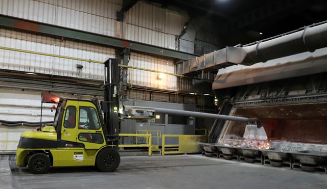

At Hydro Precision Tubing in Lichtervelde, Belgium, Clark has once again proven that "Built-to-last" is not an empty promise. The application in the cast house demands top performance from two Clark forklifts of the C55sD series every day. The trucks not only have to withstand the enormous heat of the melting oven, but also prove their abilities when handling heavy loads.

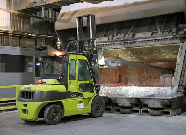

The Clark diesel forklift with a load capacity of 5.5 tons is subjected to a special endurance test at the melting furnace.

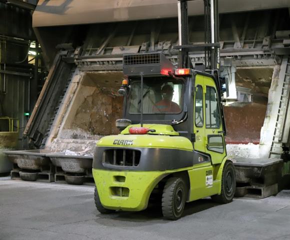

After the Clark forklift has removed the dross from the furnace, it has to remove the collection containers with the dross.

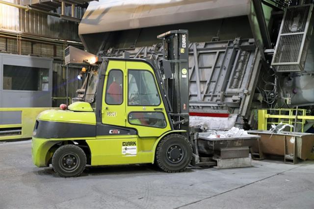

The forklift is equipped with a rotating 5-metre long mandrel, at the end of which there is a scraping device with which the forklift removes the dross. The truck is exposed to very high temperature around the clock.
Daily endurance test
Clark forklifts of the C55sD series with a load capacity of 5.5 tons have been working on the re-melting part of the cast house for a little over a year. Old aluminium is melted here at temperatures of up to 700 degrees. Their task is to remove the dross from the hot furnace after each melting process before it is refilled. Strictly speaking, only one Clark forklift truck performs this task. Since the operation runs around the clock, the second forklift serves as a back-up and for transporting parts within the cast house. "We only shut down the melting oven and casting furnace once a year for maintenance," explains Yves Viaene, Manager Foundry, Hydro Precision Tubing. "If a vehicle breaks down for any reason, we need to have a replacement truck on hand immediately so that production does not stop. For this reason, we have purchased two identical Clark forklifts."
In order to remove the dross from the furnace, the truck has an attachment with a rotating five-meter-long mandrel. At the end of the mandrel is a scraping device with which the truck removes the dross. This is not an easy task, as the forklift is exposed to very high heat around the clock, despite the long distance from the oven.

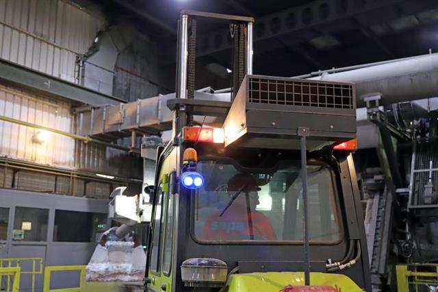

The truck had to be equipped with a Clark Blue Safety Light to comply with Hydro's strict safety regulations.

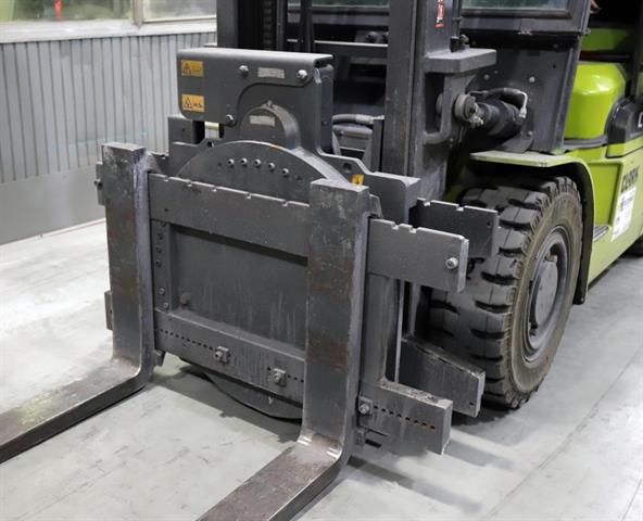

In order to be optimally equipped for the demanding task, the trucks had to be protected against the intense heat on the one hand and equipped with additional safety features on the other hand, in order to meet Hydro's strict safety regulations. Clark's dealer in Belgium, Hendrik Deceuninck based in Izegem, took a close look at the application and the specifications and then presented Hydro with a forklift operation concept, taking into account the special requirements. "We had to protect all heat-sensitive electronic parts against the effects of heat," explains Marino Dendooven, sales consultant at Hendrik Deceuninck. "The windscreen was fitted with additional heat-resistant glass to prevent it from cracking, and the air conditioning system was also protected against the heat. In order to comply with Hydro's strict safety regulations, the vehicles are equipped with the Clark Blue Safety Light, which is attached to the top of the overhead guard frame and projects a large blue dot onto the floor. "In this way, people and other forklift drivers are warned of approaching vehicles," says Dendooven. The Deceuninck company also enclosed the Blue Spot to protect it from heat - as well as the hoses of the rotating attachment. The OptaFleet fleet management system is used to monitor the engine temperature of the truck. It warns the driver, if the truck is overheating. The mast is also of particular importance in the demanding task of the truck, which is put under enormous strain by the heavy attachments. "The predecessor vehicles of a market competitors were constantly defective because the mast could not withstand the hard application," says Yves Viaene. "We have now solved this problem with the Clark forklifts." The Clark mast with a robust torsion-resistant 6-roller fork carriage and adjustable inclined support rollers ensures the best possible distribution of the load and minimal play.
Clark has enclosed all heat-sensitive components and also the air conditioning system to protect against the effects of heat. The windshield has been fitted with additional heat-resistant glass to prevent it from cracking.
The hoses of the rotating attachment were protected against the heat as well.
