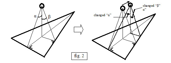

The two front wheels' ground contact points and the centre pin define a forklift stability triangle as illustrated in Figure 1.
Should this combined center of gravity (C.G). stay within the profile of the triangle; the forklift is considered stable both longitudinally and laterally. The longitudinal stability "α" and the lateral stability "β" are illustrated in Figure 2.
Lateral and longitudinal stabilities are inversely related. The combined C.G. can be moved backwards most commonly by adding an extra weight on top of the counterweight. The longitudinal stability increases as the angle "α" increases and the forklift can lift more weight, as illustrated in Figure 2.
But, we must not forget if the combined C.G. moves rearward, the angle "β" decreases at the same time. In other words, increasing longitudinal stability also decreases lateral stability. When lifting height is high, say over 4 meters, the lateral stability dictates the lifting capacity. Remember, additional weight may appear to increase lift capacity, but it compromises lateral stability.
The use of double front tyres or expanded front axle tread are effective in increasing lateral stability without sacrificing the longitudinal stability as the base of the stability triangle is prolonged. If any attachment moves the load laterally, like a side shifter, wide tread or double front tyres can minimise the residual capacity reduction.
If the rear axle mounting position is raised, lateral stability is also increased since the top of the stability triangle is lifted (Figure. 3). This design now appears to be gaining popularity.
