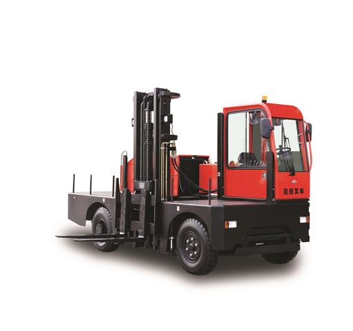

Timothy says the standard sideloader market density has never increased to the same degree as that of frontloader machines and is now under pressure from other variant sideloader models. Isa Hua Zhang, marketing manager for Chinese manufacturer Hangcha, concurs and says that in 2016, the market for conventional sideloaders will remain static or may even see a small decrease.

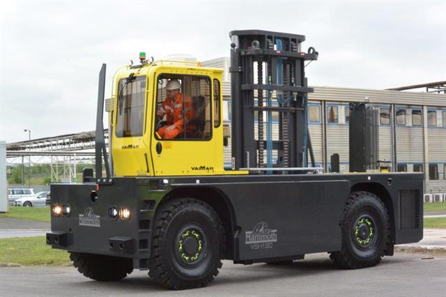

Valmar VSH180 - 18T sideloader working at Outokumpo steel refinery, Sheffield UK
However, Timothy also believes that the conventional/standard sideloader hasn't had its day yet. "All-in-all, the sideloader, whilst seen by some as a niche machine, has its use in operational utilisation, firmly established as a flexible, compact, narrow-aisle workhorse, with an ability to operate where front-loaders fear to tread." With this confidence in mind, Valmar recently added the 18 T capacity Mammoth to its re-designed standard sideloader range. The Mammoth was built for the steel industry and three have been commissioned for the Outokumpu stainless steel facility in Sheffield, England. The Outokumpu machines have been purpose-designed to handle stainless steel billets to 12 m in length and are equipped with full hydrostatic power-on-demand hydraulic and drive services.

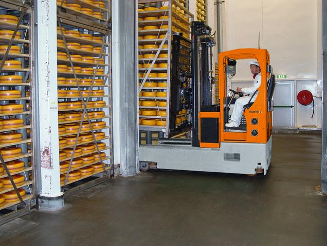

Hubtex managing director for sales and purchasing Hans-Joachim Finger says: "Compared to conventional sideloaders, the demand for customer-specific multidirectional sideloaders has grown above average in the past few years."

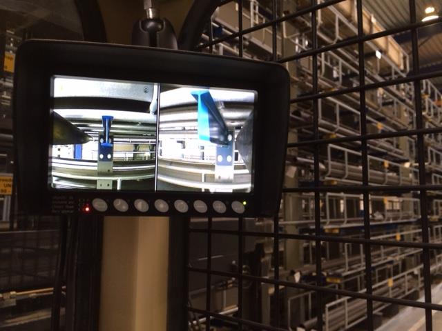

Orlaco 7
Orlaco 7" split screen monitor with front and rear views
Laurens van der Rijt, senior account manager with Dutch camera and systems manufacturer, Orlaco, believes that because of the types of loads they are regularly required to shift, vision in sideloaders is more limited than for other load vehicles. They are often "a big, moving blind spot", he says.
Orlaco AMOS camera mounted on sideloader forks
"The interesting thing about sideloaders is that every situation is different. The choice of our camera and RadarEye active detection system is often determined by situation. Both the sideloader type and the load, as well as the surroundings in which the sideloader operates, can vary enormously," adds van der Rijt. Orlaco supplies camera-monitor systems to a number of sideloader OEMs including Combilift, Votex and Bulmor. The systems are forward- and rear-mounted and also provide vision on the side of the forklift and use cameras at wider angles - 102° (front/rear) and 118° (rear) on sideloaders. Due to the wide angle, the driver is given the largest possible view of the surroundings. Monitors are placed in the cabin and automatically switch to rear-view when reversing. Cameras are also mounted on the forkcarriage, with their location being determined by type of vehicle and load

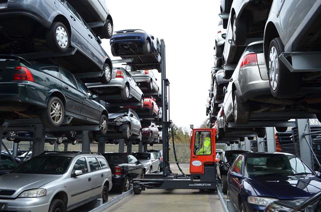

Dave Marshal, director of South West Vauxhall Spares, Swindon, UK says that the company has increased the number of vehicles that can be stored at its premises nearly fourfold since purchasing a Combilift C4000 multidirectional sideloader and new 6 m high racking bays - 144 cars can now be stored onsite compared to the previous 40. The C4000 replaces a traditional sideloader and a number of counterbalance forklifts.
"Cars are a relatively awkward load to handle and the C4000 was modified accordingly. Guided aisles were fixed at floor level, slightly wider than the sideloader, making good use of every spare inch. It also makes it very quick for the C4000 to enter in sideways mode, exit and travel down the sides, removing and depositing a car in just minutes," says Marshal.
