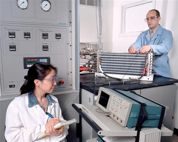

Chemical engineer Sara Yu and engineering specialist Edward Polzin test a fuel-cell stack. PHOTO: Argonne National Laboratory
