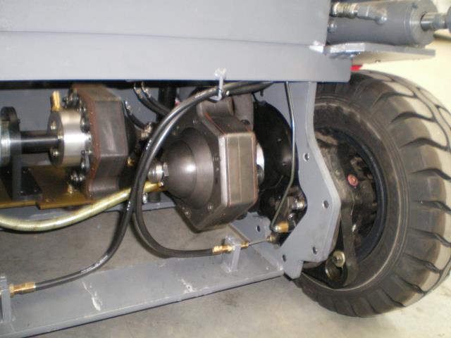

He has already demonstrated its efficiency in running a motor vehicle, a market trolley, a garden utility truck, a motor scooter and a lawn mower - the next step is to develop a forklift running on compressed air, a project Di Pietro and his associate Dr James Ma, a physicist, are already tackling.
Ma tells Forkliftaction.com News that the forklift is an ideal vehicle to use the technology Di Pietro has developed, particularly in warehouse applications where zero pollution is highly desirable.
He says the project should be completed by early next year and, if successful, the team will contact forklift manufacturers to perform a full demonstration.
"The forklift we're converting will be powered by three special air motors, which replace the three electric motors in the original Nichiyu forklift. So, instead of a battery supplying electricity, we use air cylinders supplying compressed air."

The biggest obstacle that Di Pietro has to overcome in converting the forklift to use compressed air is to ensure it can carry enough to run a reasonable shift.
Ma tells Forkliftaction.com News that the forklift they're currently converting can run for two hours continuously.
"If a longer running time is required, we can just add more air tanks and increase the air pressure. At the moment we have 150 litre tank capacity at a pressure of 350 bar. But with a filling time of one to two minutes, it is really not a problem. "
