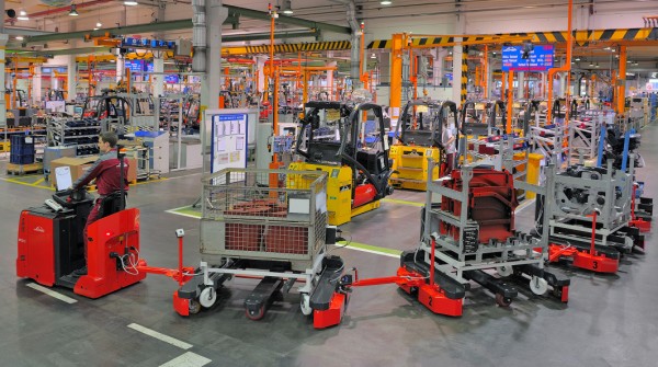

The Linde logistics train comprises a tow tractor and four specially designed trailers.

The Linde logistics train comprises a tow tractor and four specially designed trailers featuring an integrated lifting system. The train ensures that the production logistics has streamlined processes in place and synchronises the act of procuring and using the materials.
Its core task is to ensure a continuous, steady and seamless supply of materials. Leading the train is a tow tractor with three to five tonne pulling force. It can be operated manually. The trailers are equipped with a lifting system so that steel-framed material trucks with four rollers can be mounted at the side. A front tiller and rear trailer coupling enable individual trailers to be connected to make up a logistics train.
