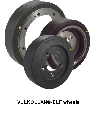

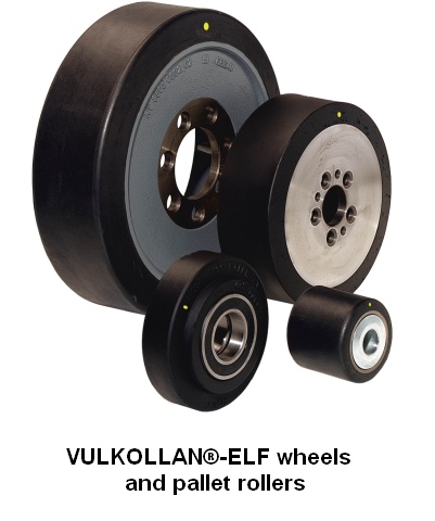

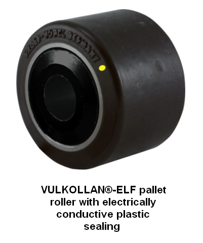

Today RAEDER-VOGEL® manufactures drive and load wheels, stabilising wheels as well as guiding wheels and pallet rollers with VULKOLLAN®-ELF tread.
The load capacities of VULKOLLAN®-ELF wheels exceed the load capacities of the VULKOLLAN® wheels with brass brush and are also higher than the load capacities of electrically conductive rubber wheels. Contrary to rubber, VULKOLLAN®-ELF is non marking.
It is of special importance that electrical discharging takes place through the whole tread and over the whole contact surface. Consequently a continuous and safe discharging, regardless of the tread wear, is achieved. The volume resistance of the wheels is always below 10.000 ohms and thus exceeds the requirements of the European standards DIN EN 12527 and sqq. Each wheel is tested before shipment.
