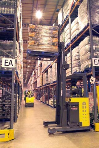

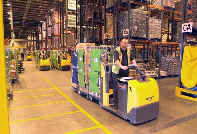

To meet the constraints of the aisle width and so that Waitrose would comply with the industry GN9 safety clearance standard, Atlet recommended a specially designed version of its Forte UNS reach truck with a very small turning circle. Ultimately Waitrose specified 8 Atlet Forte UNS reach trucks, 24 Tempo PPL low level order pickers, 12 XLL ride-on powered pallet transporters, 5 Nissan counterbalance trucks and a number of hand pallet trucks to provide a comprehensive range of storage, handling and picking capabilities. Waitrose has also standardised on powered pallet transporters with 3000kg minimum capacity to support flexible handling of multiple pallets and picking cages.
