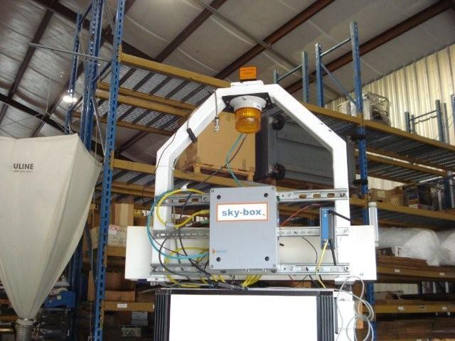

Sky-Trax Optical Position Sensor (orange box) mounted on a demo AGV together with a temporarily installed Sky-Box controller

The IPS sensor is a digital camera and image processor that is mounted onto a vehicle so it looks up to the ceiling. It works by capturing and processing an image of the ceiling at 10 times per second and based on what it has seen in the image, is able to calculate where it is in the building.
The demonstration at Amerden's facility involved retrofitting an automated vehicle originally designed to use standard laser guidance systems with Sky-Trax's IPS. With a few tweaks to the AGV controller software, the AGV was able to navigate freely within the warehouse, pick up a pallet and precisely move it to a new storage location.
Roland Anderson, president of Amerden AGVS, says only software modifications to the standard CB40 AGVE controller software were required for the demonstration.
