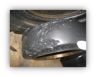

Tire Chunking
Tire chunking—the loss of large rubber pieces from the tread—often occurs due to abrasive surfaces, overloaded equipment, or aggressive maneuvers. This issue compromises traction and exposes the tire’s inner layers, leading to further damage. To reduce chunking, avoid rough or debris-covered floors (and ensure your warehouse floor is clean) and ensure loads stay within the forklift’s capacity.

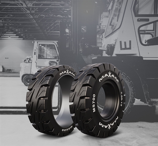

Of course, when the time comes you are looking for a forklift tire replacement, consider MAXAM’s MS600 and MS700 tires for your next operation and let us redefine what uptime means.
