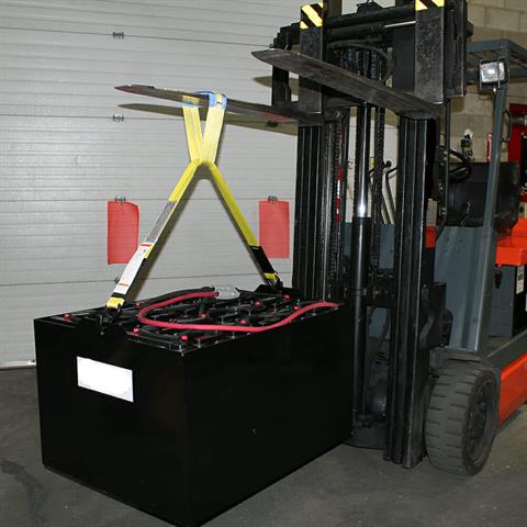

Lead-acid battery technology for electric forklifts is over 100 years old. No wonder electric-powered forklifts were (and still are) built around lead-acid batteries, which determined the format of a power pack and the whole design of a lift truck. Lead-acid technology's key characteristics are the low voltage (24 - 48V), high current, and massive weight of the battery, and, in most cases, the latter is used as part of the counterweight to balance the load on the forks.

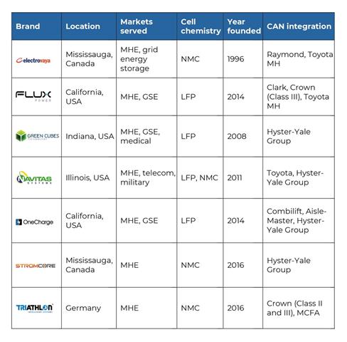

Top 7 forklift battery brands in America pioneering the transformation of MHE
This review covers a few of the most prominent brands in the USA and Canada competing for the growing share of lithium forklift batteries in North and South America. These are the seven Li-ion forklift battery brands that are driving the adoption of lithium technology by customers and forklift manufacturers (OEMs).
